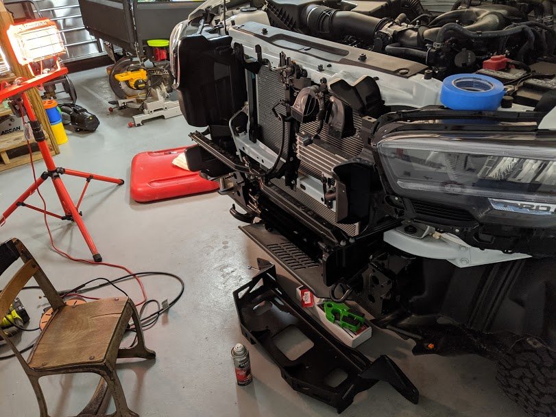

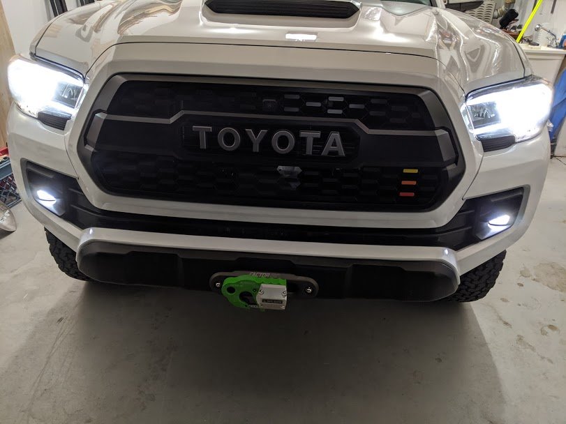

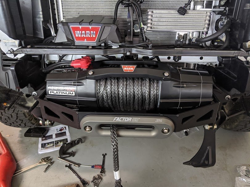

    I did the SDHQ hidden mount with the Warn Zeon 10S, couldn't be happier. I went slow on the install, stretched it out over 1 evening and finished up the next day. Only addition I'm making is adding an On/Off switch to kill the power to the winch when not in use. I'm going to use the Blue Sea Systems HD-Series Heavy Duty Battery Switch since it is rated for 600 amps continuous (winch draws 435 if I remember correctly). I'm in process of 3D printing a mount for the driver's side fender bolt holes now. Hopefully the test print piece is good to go without any changes, takes forever to print...

    I'm really liking the SDHQ hidden mount

    Bro that thing is sick. I'm looking at them now and they look hecka expensive.
