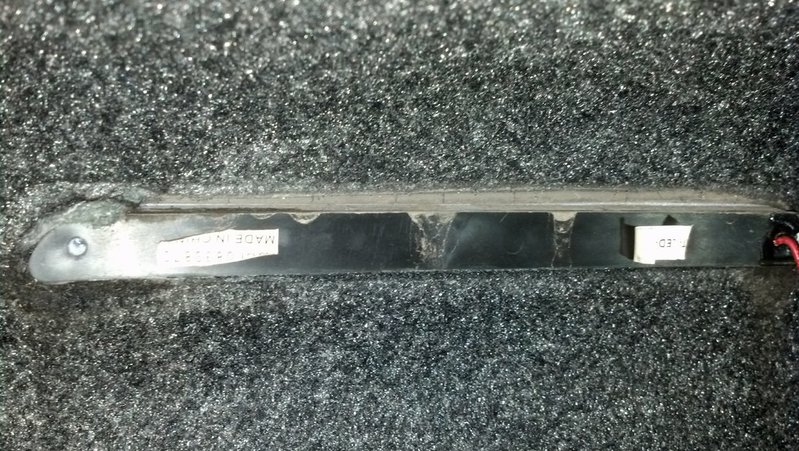

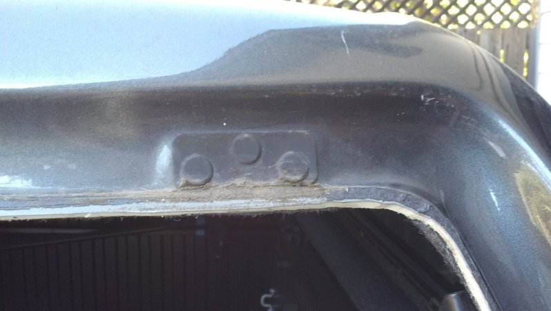

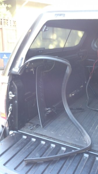

    I bought a used Leer XQ lb for $900, I ended up having to repair reapply the rear glass seal, 3rd brake light mount/gasket, fiddling endlessly with the funky/finicky frameless rear hatch latches and lock, and a very hard to find pop-out window crank. I got it all done over time, but it was a PITA and time waster because the design of this mechanisms is inherently fragile. I would never buy a frameless glass Leer again. And the ventilation sucked, you cannot screen the pop outs against bugs effectively. The MGM color did not match, but was a decent complement to silver.
    Inside 3rd brake light leaks
    "Auto locking" rear latch, never even bothered installing the wiring because the mechanism was so unreliable.
    This was a lesson in "keep it simple, stupid"

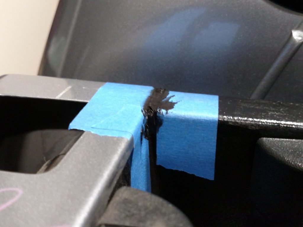

    Zero leaks. I caulked to two front bed wall seams. I added a dust seal under the plastic cap rails.
