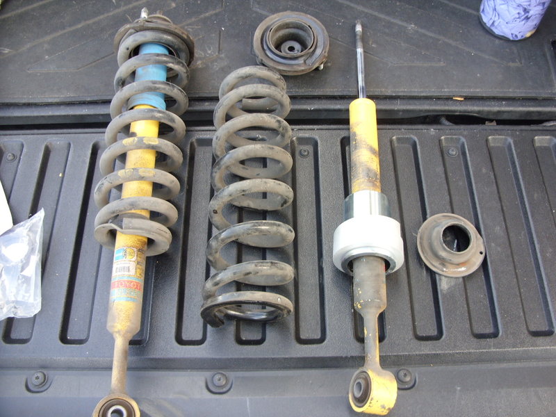

    thanks, I can figure out the rest of the stuff pictured (top middle), but what is that sleeve looking thing in the kit? where does that go?
    #92

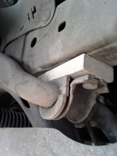

    these are my struts
    I don't really see anything that would lower them by replacing the spacer with another spacer that looks to be the same exact thickness?? :notsure:
    can you see why im not understanding what actually changes the strut height? could it be that the kit for my truck looks different then the one in the picture?

  14. Nov 1, 2015 at 9:37 PM
    #94
    hemitruk
    hemitruk Old man , young boi truk
    Oct 17, 2009
    #24461
    2,302
    Kurt
    Hawaii
    2010 Dbl Cab Sport,
    A few
    Pics of front struts. Remove stock bottom seat mount (knock it off) then install spacer and new spring mount. Can see the difference. Also pic of sway bar spacer. Looked at the kit for the 04 . Looks like works the same way.
    Kit will work with only the struts that came with your truck. Dont know if spacer same diameter as the strut you want to buy.

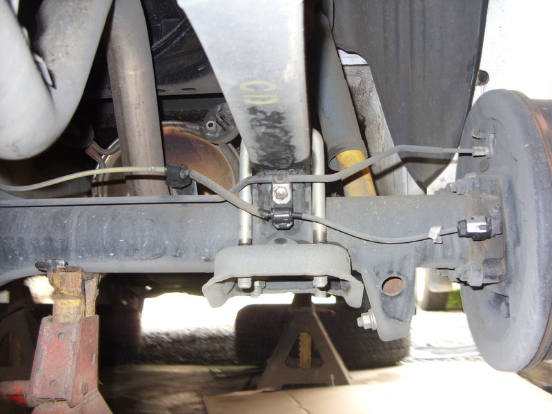

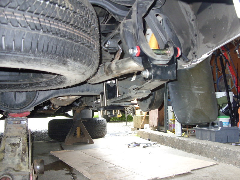

  16. Nov 1, 2015 at 9:42 PM
    #96
    hemitruk
    Oct 17, 2009
    #24461
    2,302
    Kurt
    Hawaii
    2010 Dbl Cab Sport,
    A few
    pics of rear

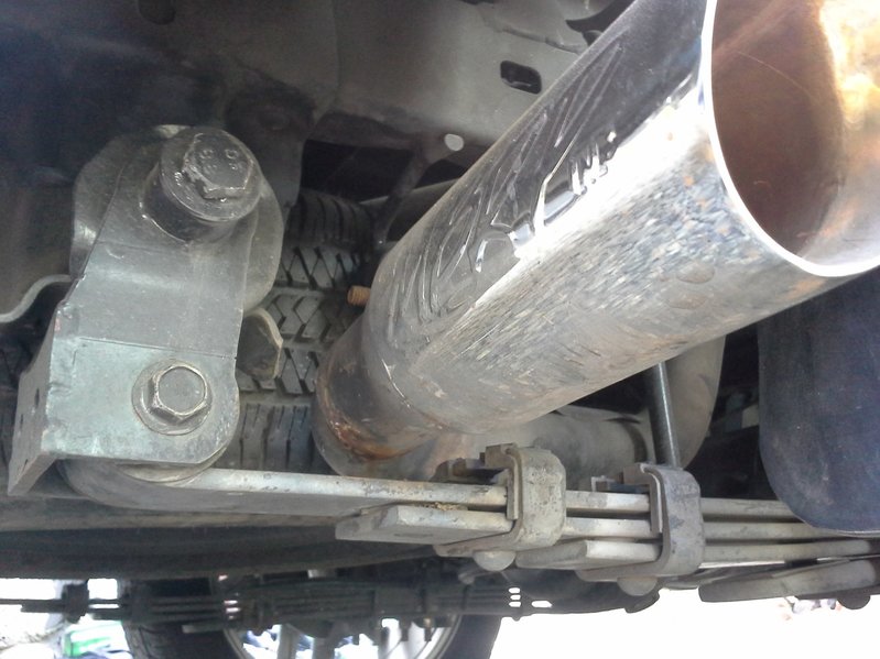

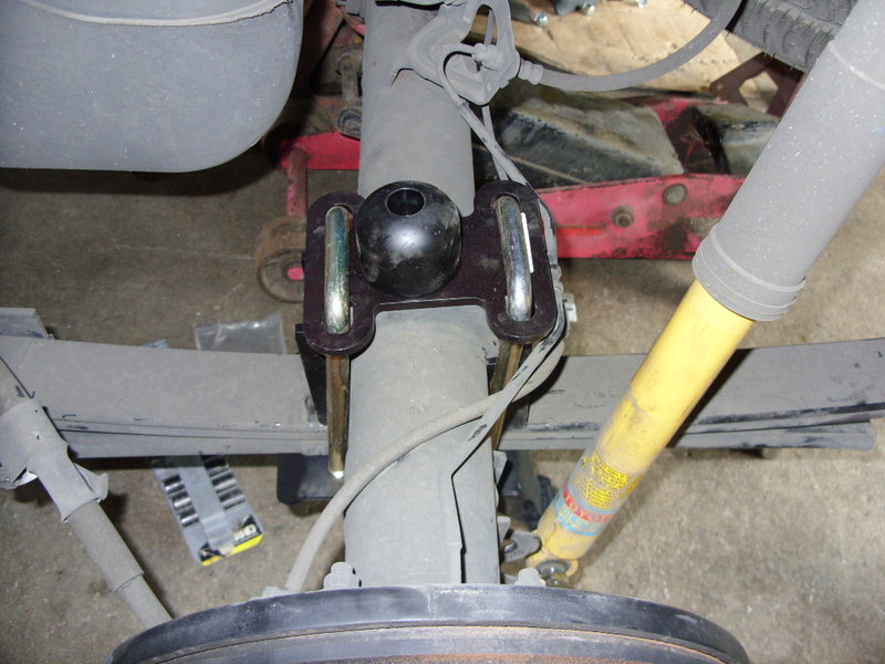

  20. Nov 2, 2015 at 8:50 AM
    #100
    hemitruk
    Oct 17, 2009
    #24461
    2,302
    Kurt
    Hawaii
    2010 Dbl Cab Sport,
    A few
    Actually 2nd gen has spring over axle also . Pic before moving under axle. And 2nd pic moving under.
    The block is needed because cant mount spring on bottom because axle is round. Block clamps onto axle and gives you flat surface to mount springs.
