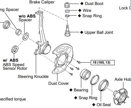

    Im about to remove the passenger side because of this, adjusting helps for awhile but time to get it off- if the 4 bolts are not seized

    FWIW, You won't able to remove the dust shield (intact) without pressing the hub out:
    See @Timmah!'s video here:
    https://youtu.be/Dj-2IzO9RFk?t=1094 (I think I got the start at point correct).
    That's not to say you can't just remove the bolts, and then cut the shield off.
    TWJLee[QUOTED] likes this.

    2020 Tundra GFC 33’s Borla Pro XS FOX 2.0 2020 F150 33’s Magnaflow FOX 2.0 2001 Tacoma 4x4 2.7 5spd access cab new frame 217k 2” lifted Always for sale.
    thanks for that info—I did not know this, until a few months back. Got new backing plates in the garage-Apparently no one likes doing this wheel bearing job either,
    Thats The plan, then if the bolts did come out,
    (had one break on a other truck) cut the new back plates in two, and rebolt them. Probably wishful thinking

    On an '03... If I had original front wheel bearings at this point, I'd just change them out rather than do all that cutting.
