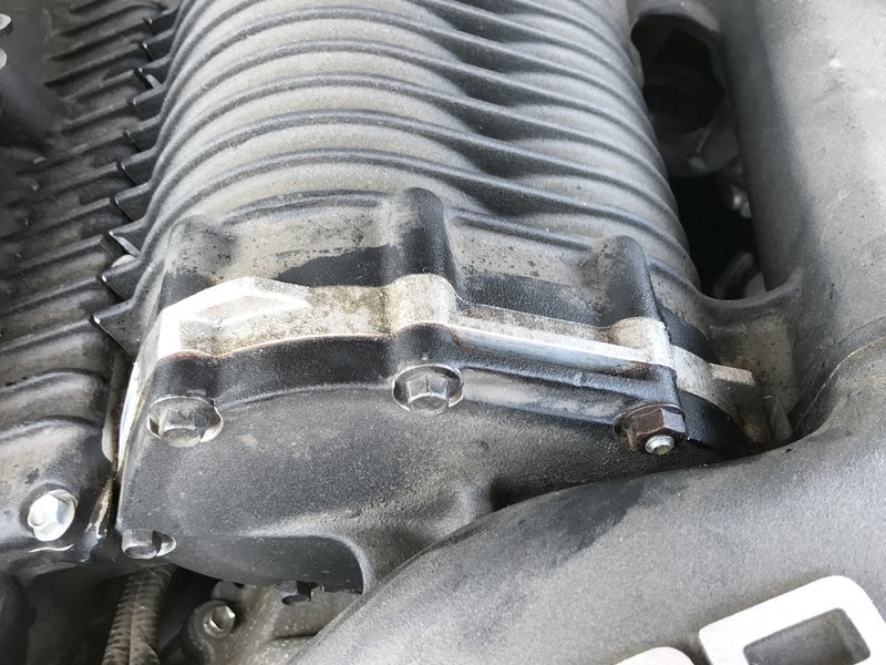

    2013 NBM AC 4.0 4x4 Auto OR
    your blower is leaking oil, it has oil on it
    it should be dry as a bone
    the rest of the stuff is normal dirt

    Yes
    Your welcome :thumbsup:
    :boink: My point is that a bunch of crusty white spooge all over his engine bay is not galvanic corrosion... half his pics were of plastic parts amigo. He clearly has some sort of fluid or road crap leaving residue in his bay. Hell it's more likely that he used the soap wand at the car wash and did't rinse it off and it dried all crusty like that than having galvanic corrosion on every single surface under his hood or galvanic corrosion on plastic and rubber.

    But seriously OP; looks like there could be some issues with the supercharger being a big culprit to what you're noticing (and maybe some a sprinkle of salt/beach/road grime thrown in). Try searching the S/C leaking problem and see where you get.

    The supercharger reservoir is known to leak from a little nipple or the fittings. Make sure your reservoir is near topped off.

    For some reason, I never saw all these responses...anyway, dealer confirmed that it was a coolant leak, one of the hoses from the s/c was leaking. Does coolant cause corrosion? I still don't get why some of the metal parts like the inside of the pulley for example is corroded.
    I was able to get them to detail the engine bay for free.

    Coolant won’t cause corrosion, per say. It actually helps perevent corrosion in the engine. It could lend a hand to corrosion in an open atmosphere as it’s an electrolyte for conducting a galvanic corrosion cell, etc.
    What pulley is corroded in the inside, aftermarket supercharger or stock coated metal pulleys?
    Without pics and details, it’s likely just normal. Normal for age, normal for salty coastal environment (you were by the coast, right?). Honestly unless parts start showing true build up of corrosion byproducts or developing cavities from metal loss, it’s likely just surface corrosion, which is common on any poorly coated metals, aka many bits on our trucks it turns out. No need for much alarm.

    It's already been covered, he had a coolant leak. It was just crusty baked coolant.
