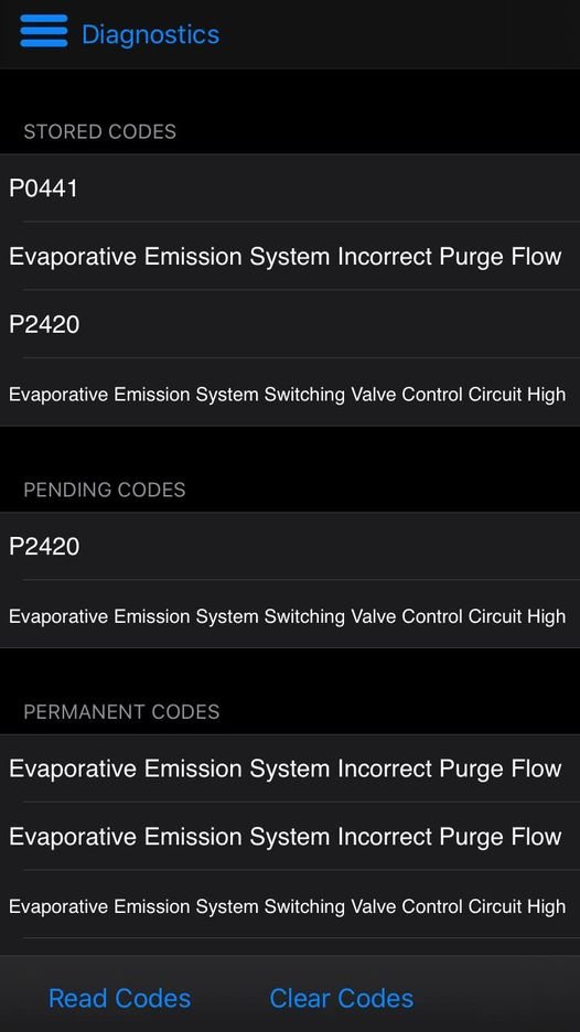

    What would cause this a p0441 and p2420 code? I replaced the gas cap and the purge valve. The codes come on randomly - I can drive 500 miles and it'll come on or sometimes after 10 miles. Any ideas? I know this is tacomaworld but not getting much help on 4runners.com
    It is a 2013 with 175k miles
    Thanks!

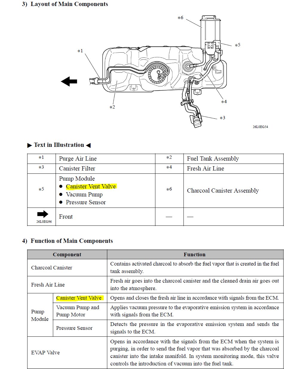

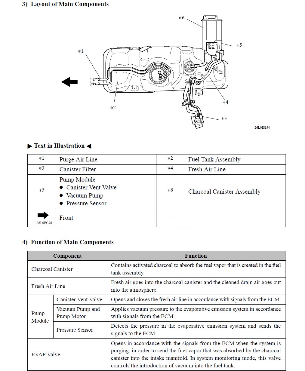

    Nooooooooo… the Vent and Purge Valves (or solenoids) are two different things. The purge valve is a normally closed valve which when opened allows vapours from the system to be directed to the TB for combustion. The vent valve is a normally open vv which vents the system, and which, if it doesn't open, would in theory at least, lead to a vacuum, or partial vacuum in your system.
  20. Feb 23, 2021 at 8:03 AM
    #20
    Rownan
    Rownan Well-Known Member
    Jul 22, 2016
    #192637
    485
    Tim
    Highland, MI
    '17 OR DCSB 6MT *Quicksand*
    hmm okay, that makes sense. Thanks.
    I cannot see anywhere in my searches that the vent valve is a singularly replaceable part. It appears to be part of the pump module which is included in the charcoal canister assembly. Is this what you are referring to?
    If so, I did replace that when replacing the charcoal canister assembly.
