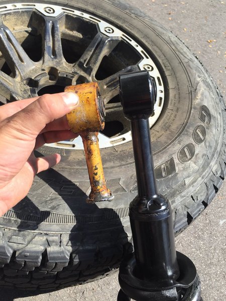

    Broke my front shock into 3 pieces my first time out wheeling

    Replaced the factory Bilstein with a Monroe from Napa. Looks much beefier, seems to be holding up so far image.jpg

  12. Oct 23, 2015 at 1:26 PM
    jessandjamie
    jessandjamie Well-Known Member
    Dec 25, 2013
    #119190
    342
    Arizona
    Do you have a spacer lift? If not how did you accomplish that?
  13. Oct 23, 2015 at 1:40 PM
    Tacoma SS
    Tacoma SS Well-Known Member
    Sep 3, 2015
    #163341
    5,084
    John
    Denver
    Supercharged 09 on 35s
    Boost and flex and 35s
    Yea block lift
  14. Oct 23, 2015 at 1:51 PM
    jessandjamie
    Dec 25, 2013
    #119190
    342
    Arizona
    Well that answers that. So you know its not a design flaw or the shocks fault, right? That it could still happen with the replacements?
  15. Oct 23, 2015 at 1:53 PM
    Tacoma SS
    Sep 3, 2015
    #163341
    5,084
    John
    Denver
    The replacements are the same size as the factory ones just thicker
  16. Oct 23, 2015 at 1:54 PM
    #16
    doyouevenprerun
    doyouevenprerun Well-Known Member
    Mar 31, 2015
    #152207
    1,397
    Jake from state farm
    Gilbert, AZ
    02 TuRD
    just got a simple lift on her
    bingo!
    need to space out the bump stops.
    you made your shocks bottom out before you hit the bump stops.
  17. Oct 23, 2015 at 1:55 PM
    #17
    doyouevenprerun
    Mar 31, 2015
    #152207
    1,397
    Gilbert, AZ
    02 TuRD
    yeah but the thing is, spacers ontop of the shock push the entire shock down. making the shock bottom out before your truck would hit the bump stops creating your shock to break. somewhat common with spacer lifts
  18. Oct 23, 2015 at 1:55 PM
    #18
    jessandjamie
    Dec 25, 2013
    #119190
    342
    Arizona
    The reason it broke is because the spacer/block made your bump stops useless and turned your shock into the new bump stop.
  19. Oct 23, 2015 at 1:58 PM
    #19
    Tacoma SS
    Sep 3, 2015
    #163341
    5,084
    John
    Denver
    It's only a 2 inch spacer lift. I didn't think I would've needed new bump stops for that
  20. Oct 23, 2015 at 2:00 PM
    #20
    nd4spdbh
    nd4spdbh Well-Known Member
    Oct 7, 2013
    #114055
    14,582
    SoCal
    13 DCSB TRD OR v6 Auto
    sounds like some experience there.
    Honestly though these trucks are pretty damn tough in stock form. As pointed out spacers on the front will mess your front struts up as they bottom before hitting bump.
    OH yes BIG TIME. you spaced the shock down at least an inch if not closer to an inch n a half... when in stock form before the spacer you only have about half an inch of extra shock travel when the LCA hits the bump stop.
