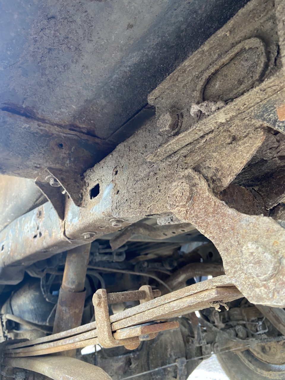

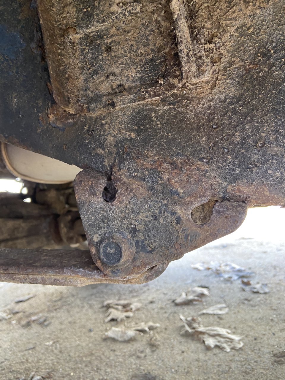

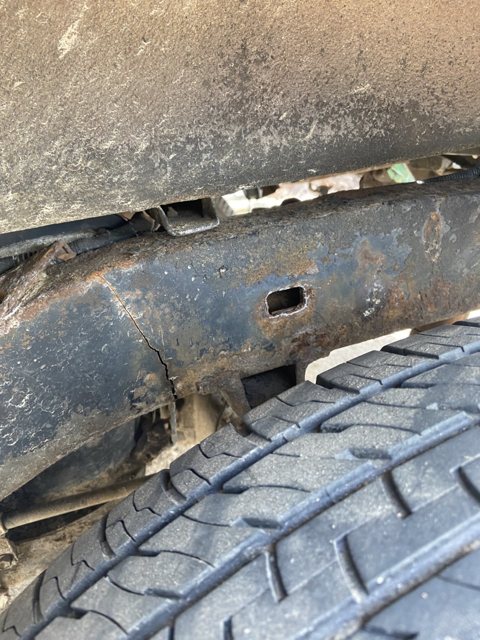

    Iswhatitis011
    Iswhatitis011 [OP] Member
    Mar 21, 2022
    #393175
    10
    03 Toyota tacoma 4x4 ext cab
    These are some photos

    And I say again,
    Trying to be practical, not discouraging.

    I am not trying to sound insulting, but, did you buy this truck a week ago and now can't get it through the safety inspection?

    This thing is going to have much worse rust than is visible sadly. I just finished going through this with a truck that had far less rust and it still took a long ass time to do correctly.

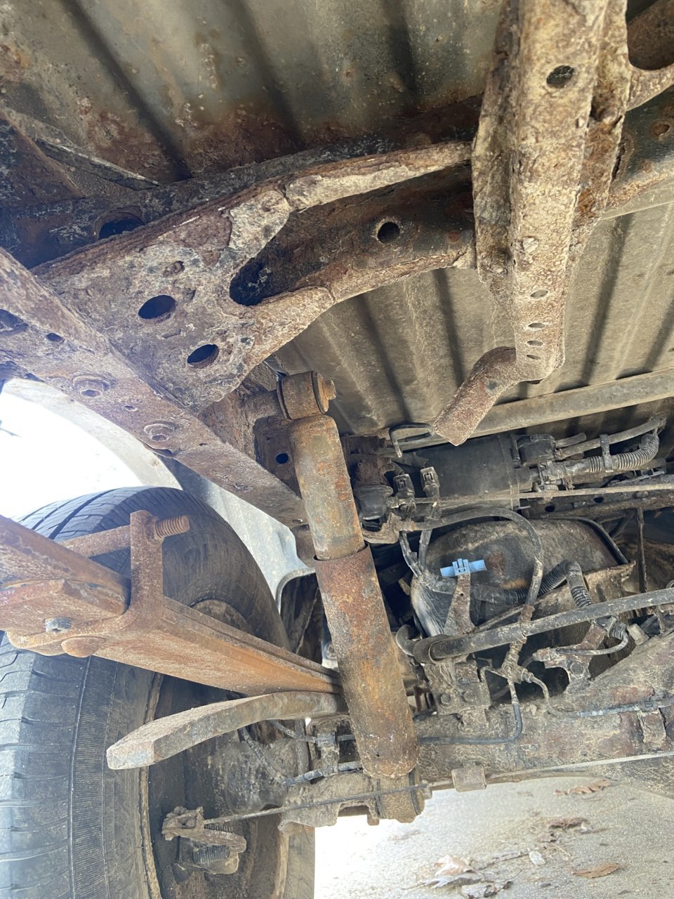

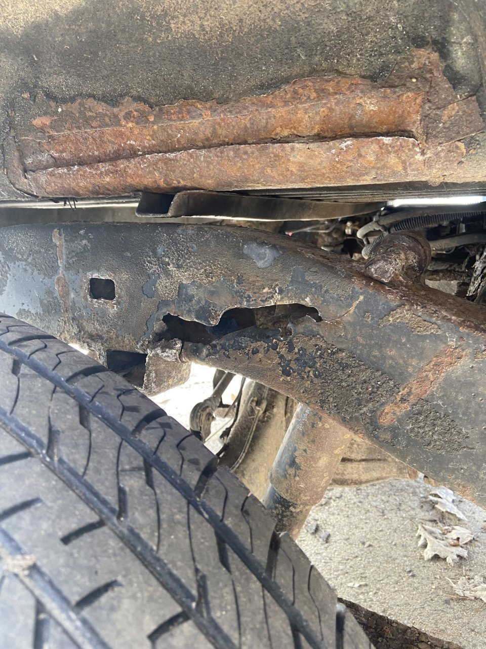

    Iswhatitis011
    Mar 21, 2022
    #393175
    10
    Just some more photos of the frame and leaf springs

    holly hell, that looks even worse than your first few photos.
    Frames aren't supposed to look like this:
    I honestly can't believe you've been driving that thing in that state. That much rust doesn't appear overnight. The crack is the least of your worries.
    That frame is toast.
