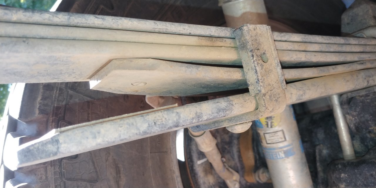

    I have a cracked leaf. I bought the truck with a lift kit installed. Is the bottom leaf the aal? Do you think because I have an aal Toyota would consider them for the leaf recall? Look closely at the 4th leaf about dead center in the first pic.

    Looks like its a aal. Looks like they took the overload out. I would just get a add a leaf set and call it a day.

    So the aal is the one that's cracked?

    Yup

    The overload is still in there, just the aal is cracked. Buy a new one for $50 and try again or ink up on a proper pack

    Often "add a leafs" that advertise a lift greater than the thickness of the leaf itself aren't a great idea. The add a leaf has a greater arc than the other leafs and ends up doing most of the work. They wear out spring pads, stress other leafs and because all the leafs aren't working together evenly, axle wrap and a harsh ride are often issues.
    On the cheap... replace the add a leaf
    To do it properly, get a quality lift spring pack.
    I know this because I went down this route and wasted time and money. Yesterday I installed OME Heavys which is what I should have done in the first place. Sometimes it's expensive being cheap.

    Had the same thing, rocked a longer single 2in AAL for awhile and axle wrap was ATROCIOUS. Been rocking OME mediums for a while and they are FAR better.

    Well if I'm going to fix it I guess I'll fix it right. Valley Springs and Service makes custom built to order leaf packs here locally, so I'll swing by just to see. Otherwise I guess I'm looking at $600 to $1000 for OME or something like that. So much for the skid plate kit I was going to get next month. :-(
