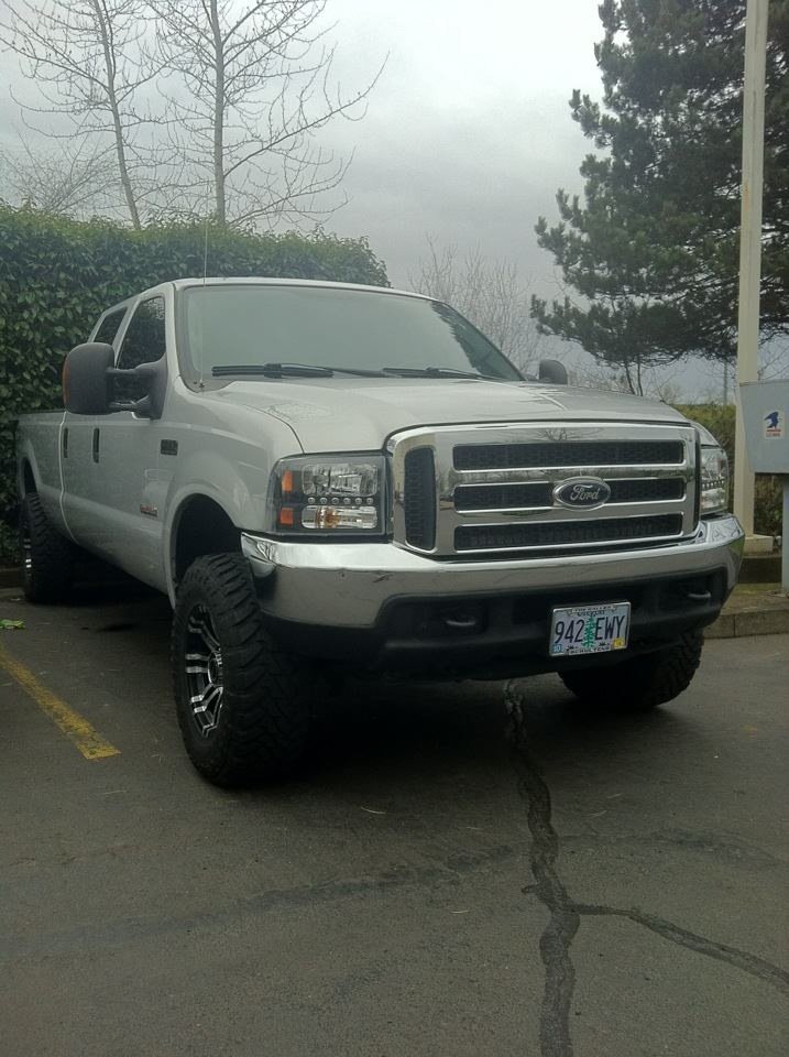

    That it does! Had a few things done to mine
    http://youtu.be/HjOGeCucNxU

    Maybe every time I went to the dealership and told them the problem they'd frown and say "yup, we know what it is." Thank god I had the warranty. $13k in repairs Ford had to eat. Definitely weak brakes. I got a big brake kit for mine.
