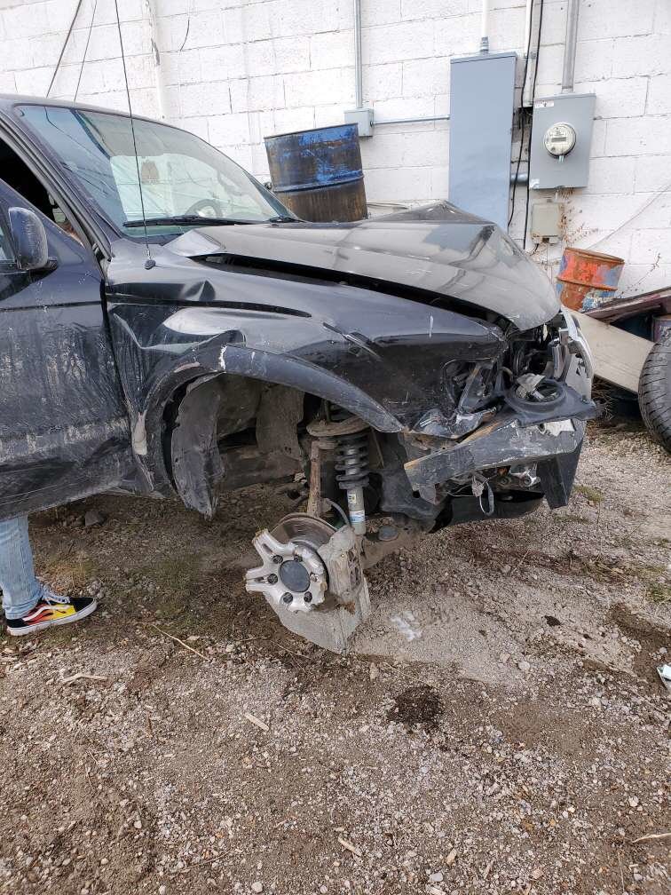

    A few months back I had a seizure on the road and drove my taco into a house. I am currently on the lookout for fenders and a hood, but I need to know what years of first gen tacos fenders, and hood will work with my 99 taco. Then from there I will buy the correct fitting parts for mine.

    Staying stock or piecing back together, you'll use a '96-'00 hood. If you found an entire front clip from '01-'04 would work too.
    Good luck with everything. Sorry to hear of the wreck and cause.
