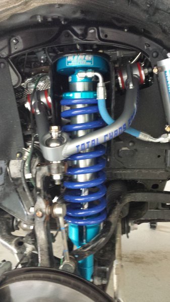

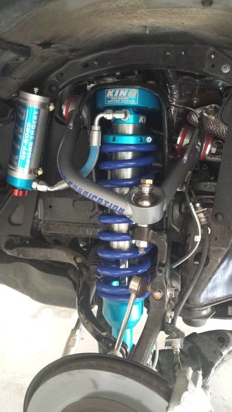

    I started to install my lift today. Got the fronts done and will install the rear tomorrow. Now to figure out what size tires to run.20160602_125822.jpg 20160602_093011.jpg 20160602_151511.jpg
