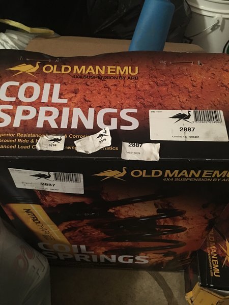

    So I hope the shop installed the right kit. I ordered a medium load OME lift kit with 888 springs. I took stickers off of the springs I say still on when I got home and they say 887 on it. Here's a picture of the box as well as a picture of my receipt.

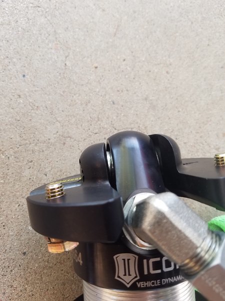

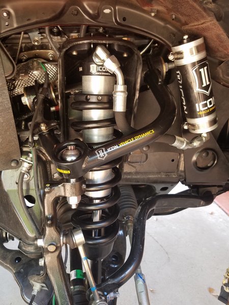

    Installing Icon suspension today. The coilover hardware is way to short fit through the holes of the spring bucket and attach the factory bolts! I'm on my way to the hardware store right now but if anybody can chime in I and let me know if I'm doing something wrong here. Nobody's open ie toytec or icon for the professional helpline lol

    Could I'd be that they go from the top and tread in to the top hat?

    Wellll.........sh!t thats that's a really good idea.....:bananadead: it 114 in phoenix. I'm claiming heat stroke lol

    Those bolts thread in from the top down into the coil over, i.e. no nuts needed. I just put a dab of blue loctite on each bolt and I've had 15k trouble free miles.

    Thanks fellas. I'm kinda embarrassed... I work 48 hour shifts just got off this a.m. and it is hot as hell today so I'm blaming it on that:D. It is coming along though.
