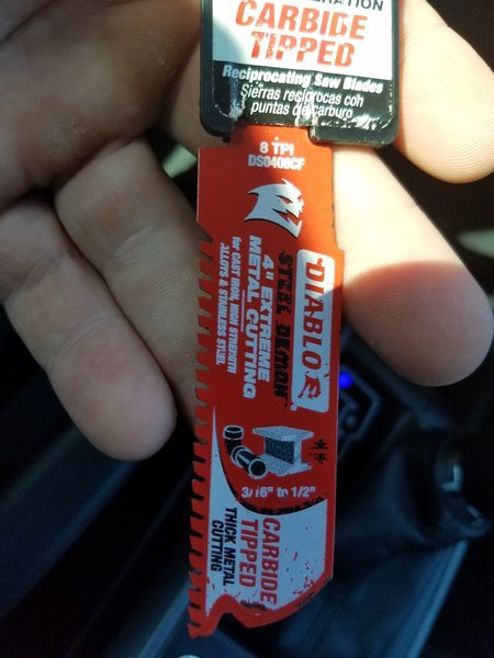

    What are you guys cutting the bolt with?

    Just a 4 inch heavy metal Sawzall blade.

    This blade on milwaukee sawzall. Like butta! Any reciprocating saw will work.

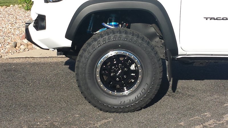

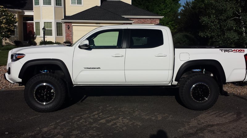

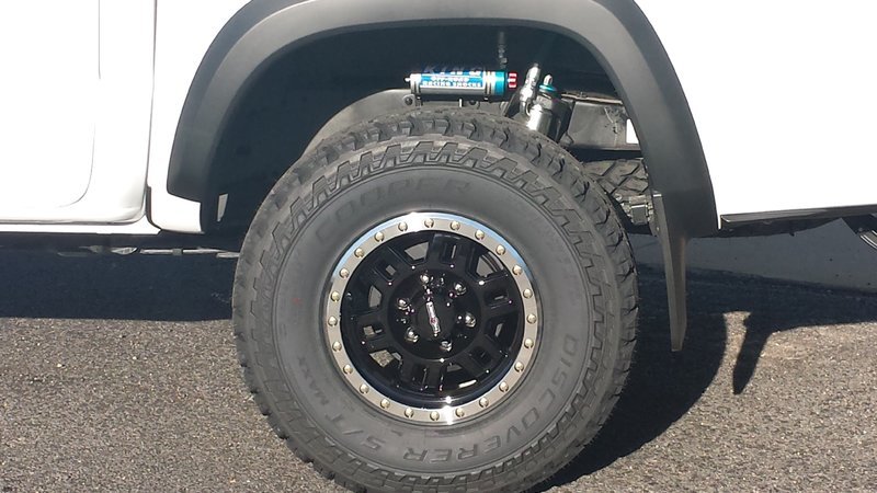

    20160615_182627.jpg 20160615_182523.jpg 20160615_182534.jpg Installed new rims and tires to go with new lift, Cooper ST Maxx 255/85r16.
