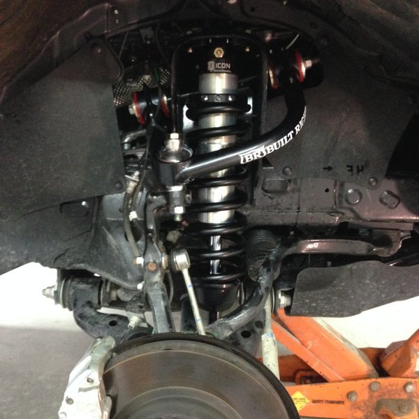

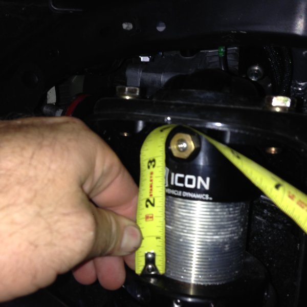

    Icon suspension, Falken Wild Peak AT3W,s, Marshall Fab sliders, Built Right uca's, BAMF grill, Cali Raised led light, Bakflip fibermax, Husky mats, Clazzio leather

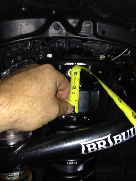

    I just got back from the alignment shop. I did Icon 2.5 extended travel coilovers in front Built Right Uca's and Icon progressive 3 leaf pack in rear with overload left in and the icon 2.0 shocks. I ended up getting 2" all the way around. That is what I was looking for as I wanted to keep the factory rake.
    I had to set the driver side at a hair over 2"of thread showing and passenger at 1 5/8" of thread showing. I was hoping to not have to crank them that much but... Anyway I guess you could go higher but you would be going over what icon suggests. The ride like everyone says is stiffer but takes the bumps and holes great! I am running 265/75/16 Toyo at2's and have no plans on going bigger. Truck is a DCLB OR 4x4.
    Center of hub to fender is
    Df22 1/2"
    Pf22 5/8"
    Dr23 1/4" full tank of gas
    Pr24"

  8. Jun 29, 2016 at 3:28 PM
    #2508
    JerryTaco
    JerryTaco Well-Known Member
    Jan 28, 2013
    #96315
    6,862
    Looks great man! Glad it all worked out!!

    Thanks man. Glad you helped me get the courage to do it myself. You da man!

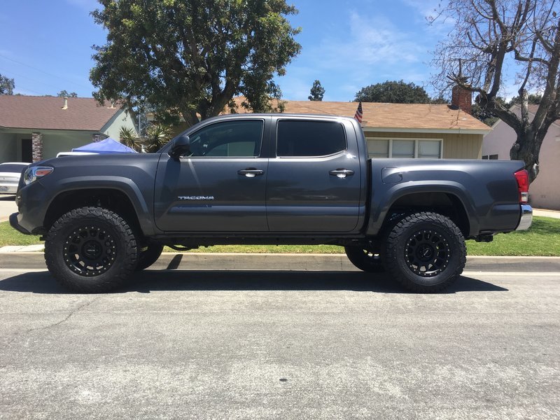

    84
    2016 Magnetic Gray Tacoma SR5
    Adjustable King Coilovers and shocks, Camburg UCA’s, Deaver add-a-leaf, BAMF Grill, Method NV's, 285/70R17 FALKEN WILDPEAKS
    No adjustment made to the coilovers and I haven't had an issue with rubbing. At the same time, I'm running stock UCA's. I got the alignment as close to spec as possible. So far so good. I'll definitely be getting aftermarket UCA's when I'm able to afford it tho.
