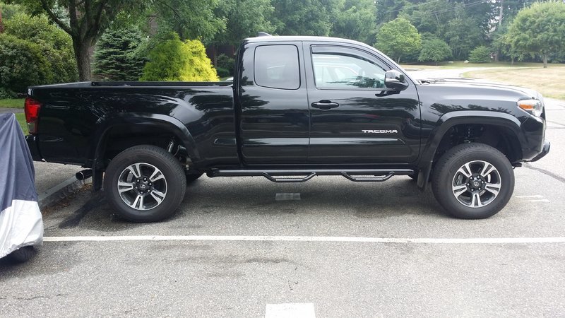

    curious how much lift i got. anyone know or care to measure their stock truck? after lift im at 23.5" center hub to fender and it looks big but maybe not. truck is a 16 AC MT 4x4. guessing i gained 2-2.5" but it looks higher than that to me.

    Is that 23.5" equally at each corner? My stock measurements were as follows (per wheel, hub center to fender lip):
    FR- 21 1/4
    FL- 21
    RR- 22 3/4
    RL- 22 1/2

    yes it went to dead even 23.5" on 3 corners and the left rear is .25" lower. i did use a toytec drivers side spacer in the front. curious because rear brake cables seem tight. surprised rear isnt higher, i noticed a slight difference just doing shocks first. figured adding the leafs would've gained more but im happy with how it sits... for now
