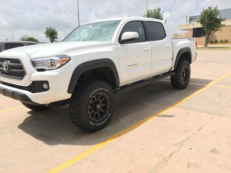

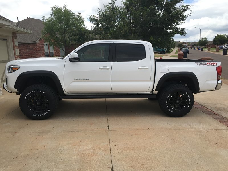

    I apologize for not responding. I missed your post. Here are some photos. As a disclaimer, that video I posted is a misrepresentation of the process. it is not that easy. But it's doable.
    2016-08-14 08.00.34.jpg 2016-08-14 13.38.31.jpg 2016-08-14 17.15.19.jpg 2016-08-18 12.10.54.jpg

    Those were 285/70r17's. They rubbed pretty terrible so I've gone to 275's. They are noticeably smaller but they don't rub.image.jpg
