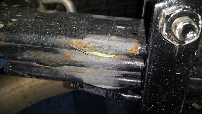

    Posted in the other big lift thread but got no intelligent response. Whats "too much" taco lean in the rear? After install there was a .25" difference side to side. Im up to 1.25" lower on drivers side in the rear. 5160 and hs progressive AAL if it matters. In my mind, a spacer would be fine for one side in the rear since the driveline angles would remain unchanged front to rear and side to side. But i never see it done so im guessing its bad idea. Why?

    What lift do you have in the front? My lift came with a 1/4" spacer for the left front strut to correct/prevent the "Tacoma lean".

    Grrr... yes i did the .25" spacer for the front. Now the front of my truck is darn close to level. The rear however is not because there is no spacer on either side. Ill tear it apart again and report back with my findings

    Is the overload leaf on both sides?

    Nah that has to come out for the aal along with the rear oem spring clamps. Thinking i might have some binding going on in the right but since i never removed leaf packs, i dont think thats my issue. May have a leaking shock but i doubt it. Guess it wouldnt be too difficult to pull and check

    I left my overloads and clamps on. I did the HS 3-leaf. Did you do the Deaver single leaf?

    No i did the hs 3 leaf also. How did you leave overload springs in? So your spring pack goes )))()))? Without it i have 6 springs all )))))) and the rear clamps are in the way unless you install backwards then i think the front clamp would be an issue

    Forget the cricket, you can see where the owm clamp was and why it'd be a problem. The friction pad on the aal would rest on the clamp rivet20160820_151932.jpg

    I'll take a picture when I get off work because I cant exactly recall but I think it went like this ))))))( The last one is the over leaf.

    If you had to cut it it will be ok. The HS leafs clamp them just fine. Shit you might even get a better ride because I have four on each side now holding them together. looser = softer...right?
