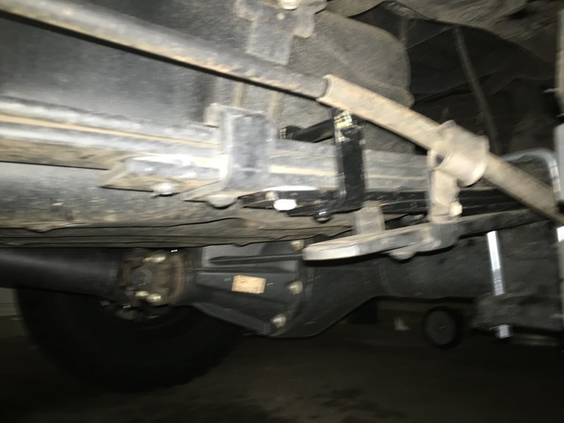

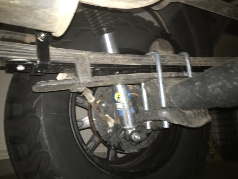

    Here's a couple pics. I didn't really want to pull off a tire. Does this help?image.jpgimage.jpg

    Yeah screw those uca bolts! That was a nightmare not just getting old ones out but getting new ones in with all the fuel lines in the way. Still stumped though. Pics did help some, smart where you put the parking brake cable guide. Since i tossed my overloads, i dont have that guide clip so i had to use bolt holes on the hs aal which makes it pretty tight but still functions.

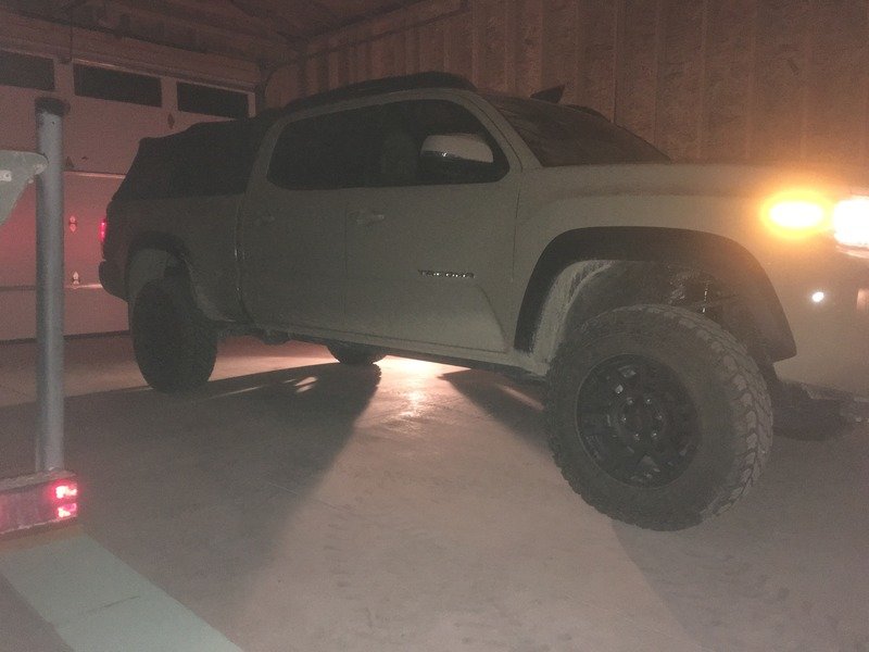

    I just installed 6112/5160's on my 2016 OR. I have 265/75/17 Cooper ST/Maxx on TRD pro wheels. I also added a 3 leaf AAL in the rear.
    6112's on the third notch, came in at 1.5" lift in the front using one 1/4 top spacer on drivers side. No rubbing etc. Put 40 miles on it felt great, nice ride! Firm but not harsh, I live several miles down a rutted, washboarded dirt road and it feels like off-road+ suspension.
