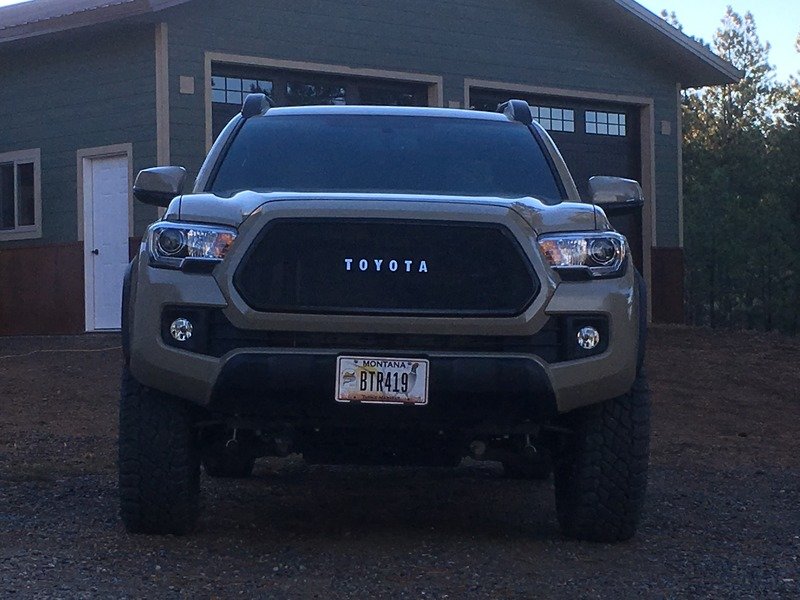

    Driveway droop test..

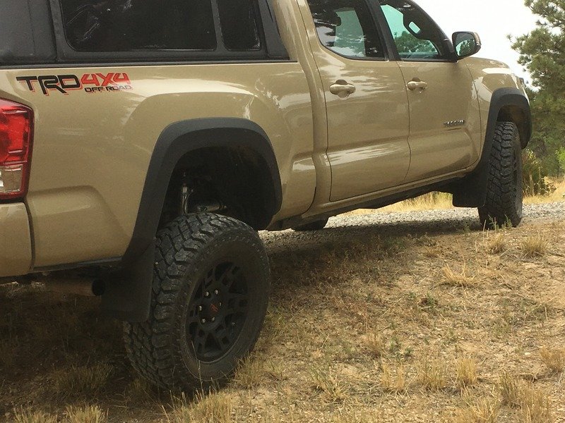

    I put about 100 miles on it so far. The best I can describe the overall ride is 'TRD OR+'. It's not harsh at all- not one bit. I drove about 20 miles on a really rutted out, washboarded road with lot's of deep holes, whoops and what-not- It did great. The suspension is 'quick', not bouncy at all. Rebounds nicely. Over the road it is compliant and feels not at all that much different than the TRD-OR it replaced- just a little faster and firmer- which I am VERY happy with.
    Install was not tough with the exception of my first AAL- It took me a little time to get that sorted out to get my suspension to droop enough. My jackstands were not tall enough- had to block them up a few times and reposition them to get it right. The second side took less than 45 minutes once I figured it out. The rear 5160's come with brake line relocation stuff, so that takes a little time. I started the whole thing at 1:00 p.m. and finished up around 7:30p.m. including putting my tools away. I was solo for the most part and took my time. Ate lunch, that sort of thing. The coilovers were pre-assembled, so that made it easier too.
    I had an alignment done yesterday at Toyota and it's in spec. Stock UCA, front coilover set at position 3. Used one 1/4" spacer on the drivers side. Lift numbers were basically spot on with 1.75 and 1.5" front lift and 2" lift in the rear. I took the overload out of the rear.

    I was leaning stock, so that spacer corrected it. 1.75" lift drivers side w/spacer, 1.5" lift passenger side no spacer. Both sides now essentially level center hub to fender.

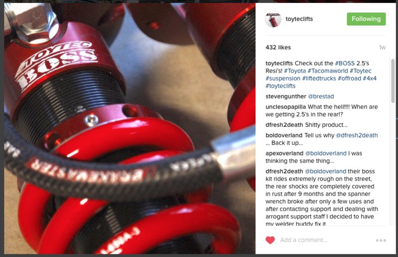

    The BOSS 2.5 line can be serviced and rebuilt as needed.

    Is that a unique feature to this brand or model shock? I ask because I paid just as much for the suspension on my motorcycle and its 100% serviceable.

    The 2.5 model line is the first serviceable shock line for Toytec Lifts. But brands like ICON, KING, and FOX are completely servicable for all models.

    I see, many questions answered in this post. Thanks old man, take it easy on your walker.
