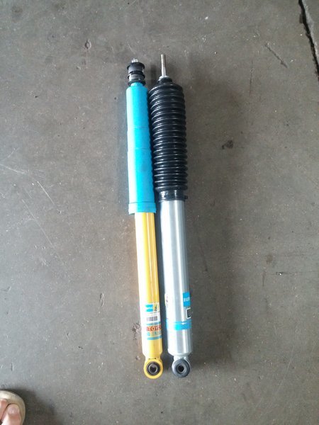

    Interesting that the rear Factory 17 TRD Bilstein shock is the same length extended as the aftermarket 5100 (0-1 inch) lift that is recommended.
    Puting 1 1/2" rear lift on it now. I looked everywhere to get factory length extended. Checked forums, called bilstien, called toytek. No one had this data. No one could give factory length. ......apparently the stock shock length is the same. I'm returning the 5100's.

    I would recommend going with our BOSS shocks for the rear. They will be a bit longer than these and are good for 1-3 inches of lift on the 3rd gens. We dont sell Bilstein for the 3rd gen Tacoma's as of now because they have not been release for them yet and we have not tested them.
    Here is the link for our boss shocks that we use on our Tacoma.
    http://toyteclifts.3dcartstores.com/Toytec-BOSS-Rear-Shocks-for-05Tacoma00-06-Tundra_p_137.html

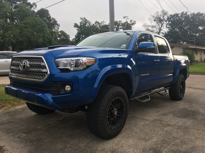

    Yes, I did the bilstein 5100s set at 2.5" and a 1" block in the rear. It gives too much lift to leave the rear at stock height. I didn't really notice a difference in the ride unless it was on a really bumpy road, and I dropped down to the next notch on my sport just because the front pokes up a little more from the hood scoop.

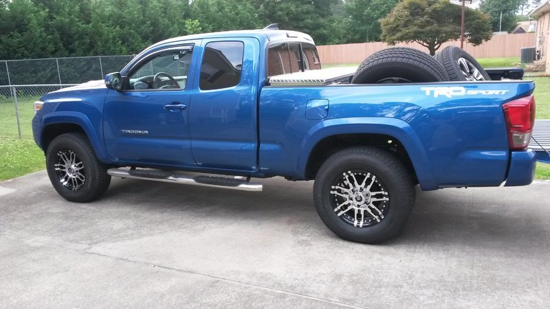

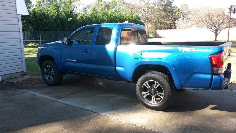

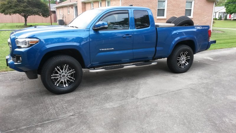

    265/70/17 can fit on stock safely. They are 1" taller than 265/65/17 so you only lose 1/2" clearance over stock. I have tons of clearance on my rwd trd sport with 265/70/17 and my wheels are +10 offset 17 x 8. They stick out 1" farther than stock +30 offset 17 x 7.5 wheels with 265/65/17. You can tell more by the 2 profile pictures.
