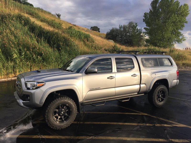

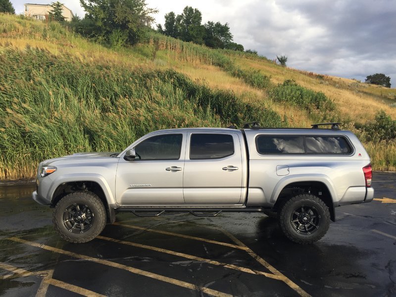

    that is a thing of beauty right there...good work. How much trimming/cbc was required to fit those tires? that's the same size of rim and tire and lift that i'm wanting to go for.

    nicely done. truck looks badass
