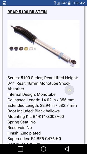

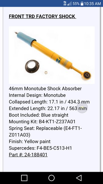

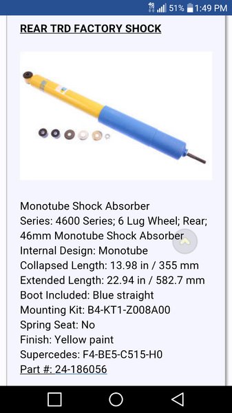

    Fino, do you have the measurements on hand to share? Full extension and full compression of both shocks?

    Hi Long Time TF. Here you go. Current 5100 front is only about 1/3" longer. Rears are the same.

    Thanks for posting this up. I've been wondering for a long time why they recommend the 5100's with OME coils but not the stock OR's. I remember the difference only being ~1/4". Seems like just 1/2" of wheel travel difference if maxing out the shock with a long coil.

    Just to clarify Bilstein has NEVER recommended OME coils on their 5100 shocks and if you do this combination chances are Bilstein will not warranty their shocks if you have an issue. However most companies that sell lifts are OK with the combination because they can somehow "warranty" the problem for you.
    Also note that 1/2" difference in shock length is roughly equal to about 1" of travel at the wheel. It's not a 1:1 ratio. This applies to the front only.

    237
    2016 DCSB TRD-OR
    1/4" difference in shock length. Equal to around 1/2" of wheel travel. I was also referring to distributors, and some TW members. Not Bilstein specifically
