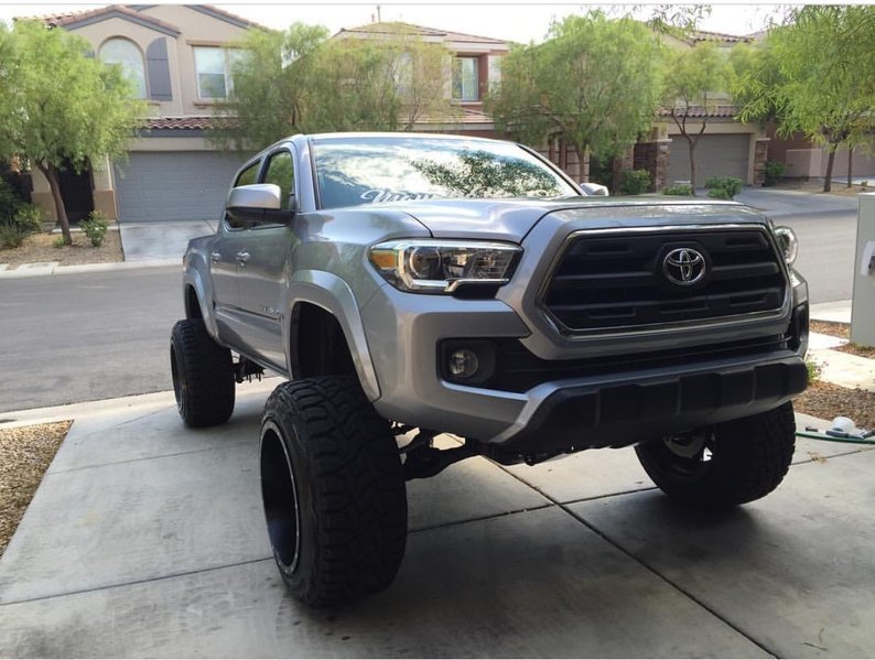

    Holy shit man, that is pretty nice. Don't misunderstand me when i say pavement princess. my philosophy has always been that in the end, it's YOUR truck. If you like the way it looks, feels, handles, by all means never let anyone stop you. It's your money, your truck, do what makes you happy.
    With that in mind, what i prefer is something a little less than what you prefer. which is why i went with the 5100's and OME 2887s. Does everything i want it to do off-road and more. :) hope i didn't offend you with the pavement princess comments.

    I take pride in being a pavement princess
    Thank you for your words
    Happy thanksgiving

    wait what!?!?!? where in the hell did you get a truck they they require you only to drive on dry roads? thats freaking insane. did your truck come with hoosier slicks?
