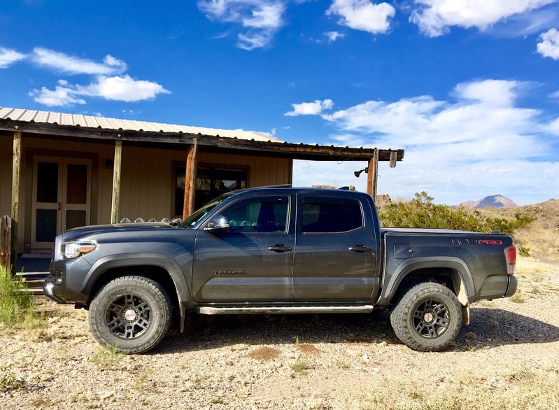

    A question, and it's probably been answered in multiple ways which I have read on a few on these forums etc.
    I have a 2016 OR 4x4.
    The only thing I want to do to the suspension is to level it.
    So should I go with just a 1" spacer up front and if so what would you recommend?
    Or is it better to go with the new Bilstein's designed for the 2016, up front....and adjust to what setting?
    And any recommendations on where to purchase.
    Thanks for any input!

    Wait, do you own an OR or TRD pro?

    I may be mistaken but I think it's an OR. I see no scoop.

    It's a 2016 Tacoma TRD Off-road, 4x4.

    i vote bilstein. you may want to look into some after market springs if you do any real off roading. They OME springs are awesome
