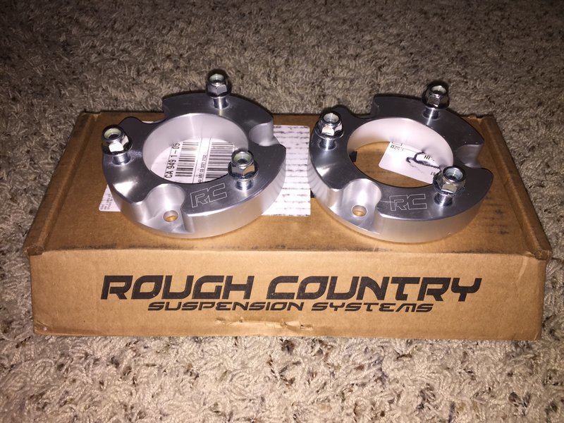

    The 5100's are firmer than my SR stock shocks. I'm running 885 springs which are lighter rate than factory. The 5100's are a bit firm for my liking on the back roads where I live, but great on the road. The Sport shocks might ride better. I'm running a 1" rear block, and there isn't any more axle wrap than stock, I'd be hesitant with any block over 1". The factory leafs don't do much to battle axle wrap.
    If you are not looking for a huge lift, a top plate spacer would be a good option to get it up in the air about an 1" or so.
