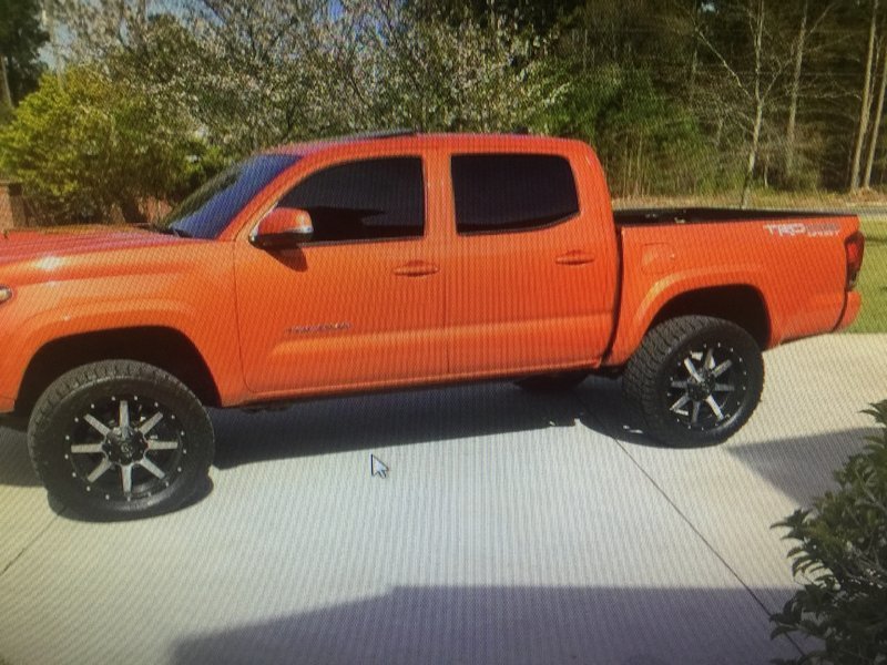

    A small handful of select mods.
    Interesting. Should work. Might have some plastic rubbing and depending on the wheel offset you might need to trim the cab mount.

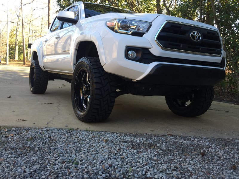

    A member posted this pic saying these were 305/55 20's but when I went to message him he hadn't logged on in a long time. Now I can't remember who it was.

    You can do a 3/2 spacer/block lift and run a 285/55/20 with a zero offset. That's what I have and I have zero rub at full lock in either direction.

    285/55 20's will not rub with a zero offset.

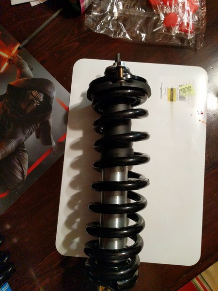

    it normal for a newly assembled coil over with an OME spring and a Bilstein 5100 to have a slight bow to it? I have not mounted them to the truck yet. I used new top plates and new rubber spring pads.

    Not that I have seen it before. Can you take off the coils and see if they have a bow in it?

    What notch are they on the 5100? If you are on the top or second to the top notch that happens sometimes. Once you install them and get some load on them that should go away.
