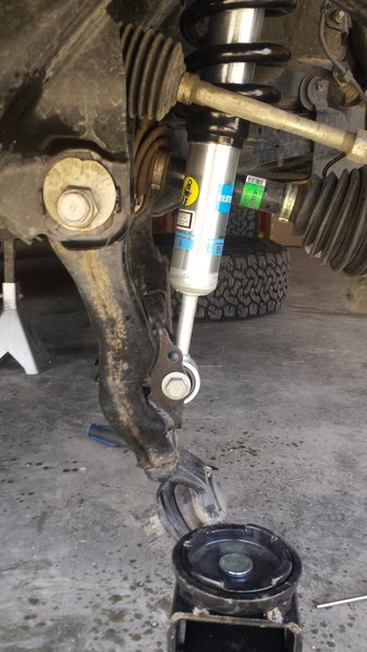

    Front Suspension King Ext Fronts 700# Icon UCA delta joints JD fab spindle gussets All Pro cam tabs DuroBumps Warfab steering sleeves Rear Suspension Old Man Emu leafs -Radflo Ext travel rears Timbrens ubolt flip kit SCS stealth 6 Wheels 35x11.5 Maxxis Razr [ 34.5 x 9.75 on 8.5 rim not on truck] Heavy Stuff Relentless front bumper Smitty 3rd Gen winch Big County Customs skid plates Arc One industries rear HC bumper RCI sliders Misc Arb dual compressor Arb rear locker Pelfreybilt fuse panel tray Cali raised ditch light mounts Cali raised bed stiffeners 5th Gen 4runner LED fog lights Racks Retraxone XR tonneau Yakima load bars Sherpa Roof Rack Camping Smittybilt Tent Dometic CFX50 fridge
    How long did it take you to realize you had the spring perch upside down? Lol

    1 hour. Of cussing and head scratching.
    Another member chimed in on another thread thankfully.
    The written instructions inside the box say to reassemble as per OEM (pitch facing up), but the visual diagram shows the opposite. Which ones do you think I followed first...lol :annoyed:
