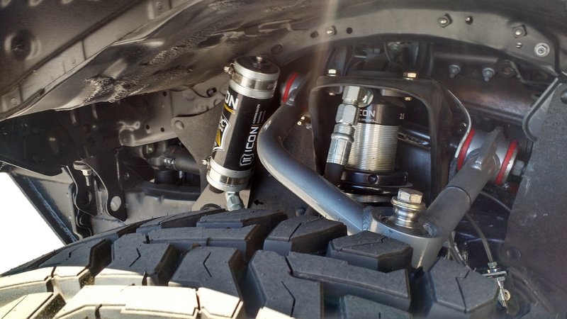

    Better off getting 14" 700lb springs vs the 13" 600lb springs that ICON typically puts on their coilovers. You can keep the cranking down to an acceptable amount that way. With the amount of thread showing in this picture the ride quality has to be suffering.
