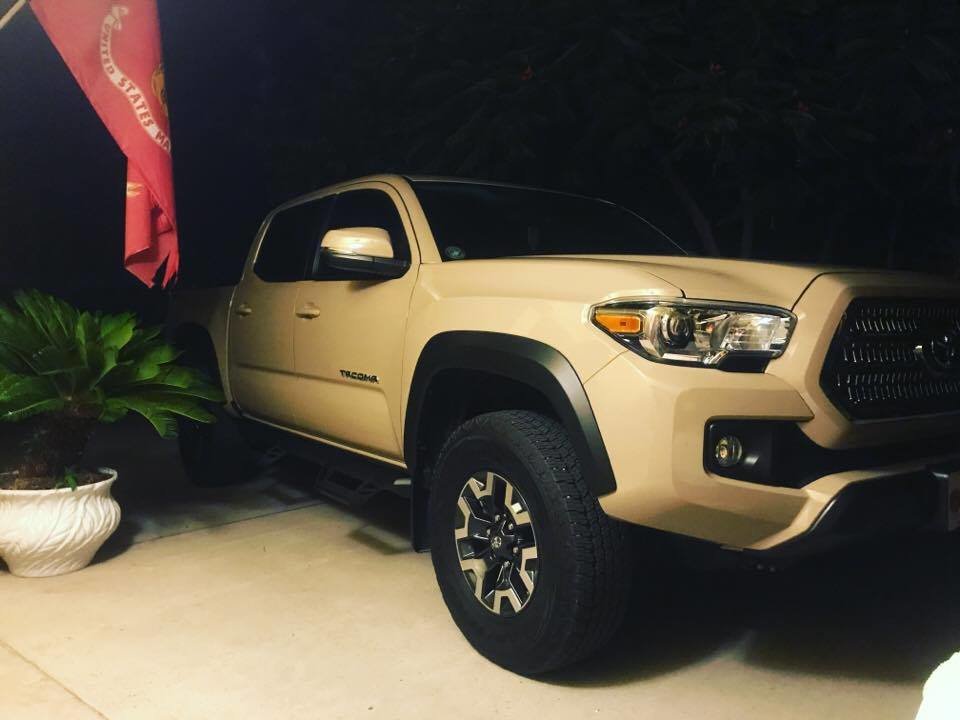

    Anyone here do just a 2" lift in the front and be able to run 33"s. Im not a fan of the 3" lift look. My plan is to get the fox or iconn coilovers and rear shocks. Purchased from toytec of course.

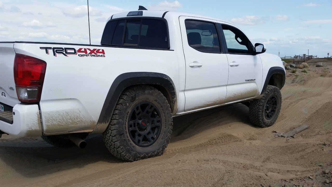

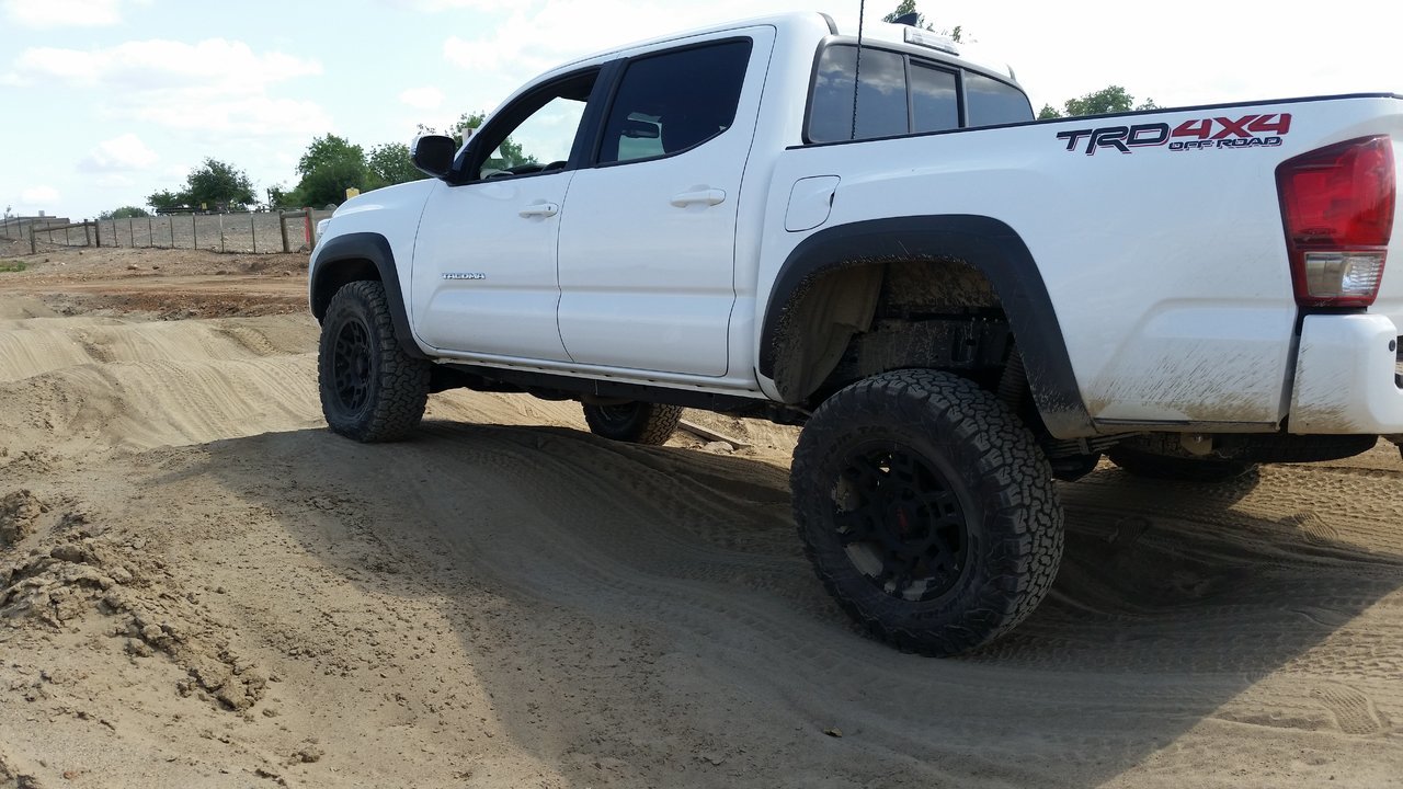

    I received some good information here when doing all my lift research. Here is what I finally ended up with:
    3-1/4" Front with Bilstein Gen. 2 5100s (set to 0), OME 888 coils, and LR Upper Control Arms
    2" Rear with Headstrong Progressive AAL with Overload still in
    4Runner TRD Pro wheels (I believe 17x7 or 8?) Im thinking of getting SpiderTrax 1-1/4" wheel spacers....
    BF Goodrich 275/70/17 K"Bro"2 tires (just under 33")

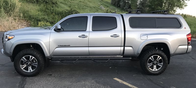

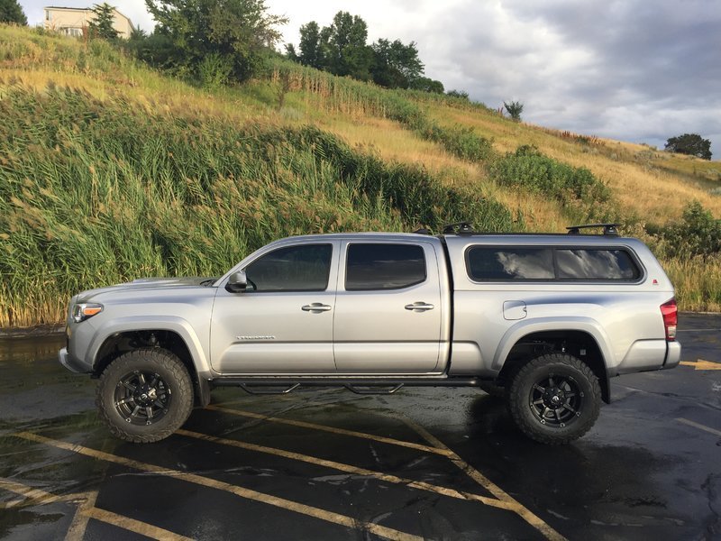

    A year later, I had to make changes so I could live with this taco...
    With a 275 70 17 tire you can make it work fine with a 2 inch lift. However, the third gen is a gutless pig and bigger, heavier tires suck out what little life there is under the hood and the taller tires make the gearing situation miserable.
    I went down from the load range E 275 70 17 bfg KO2 to load range D BFG KO2 265 70 17. I also have a little more rake as I don't have the front up as high as when the bigger tires were on(that may change a little, because it can with adjustable coilovers, since I don't want to mess with the Dakars in the back). The ride is better with the notably softer tires and there's a difference in the Icon's response with less thread showing. I get better fuel economy(still miserable in relation to power output) and the ride is better overall.
    Free Advice: Steer clear of anything load range E and get the smallest tires you can live with.

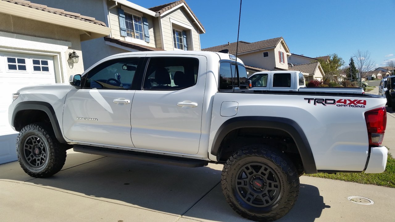

    I would highly suggest getting the matching 5100 rear shocks as well if you do the OME 888 with 5100s on lowest setting up front. I have that setup, along with a progressive AAL and left the Overload Leaf in. If you take it out, you will not be level (with my experience). Also, you should look into new upper control arms if you are doing the 888s...
    My setup:
    2nd Gen Bil 5100s (all around) on lowest setting (second gen has longer travel and a longer extension aka droop. However, dont expect much droop with that high of a lift. Going over a speed bump I sometimes top out my front shocks)
    OME 888s
    Light Racing upper control arms
    Headstrong Offroad progressive AAL with overload in.
    Sway bar relocation from Toytec
    Came out to be around $1300 shipped, take out $450ish for upper control arms if you don't like having an aligned front end.
