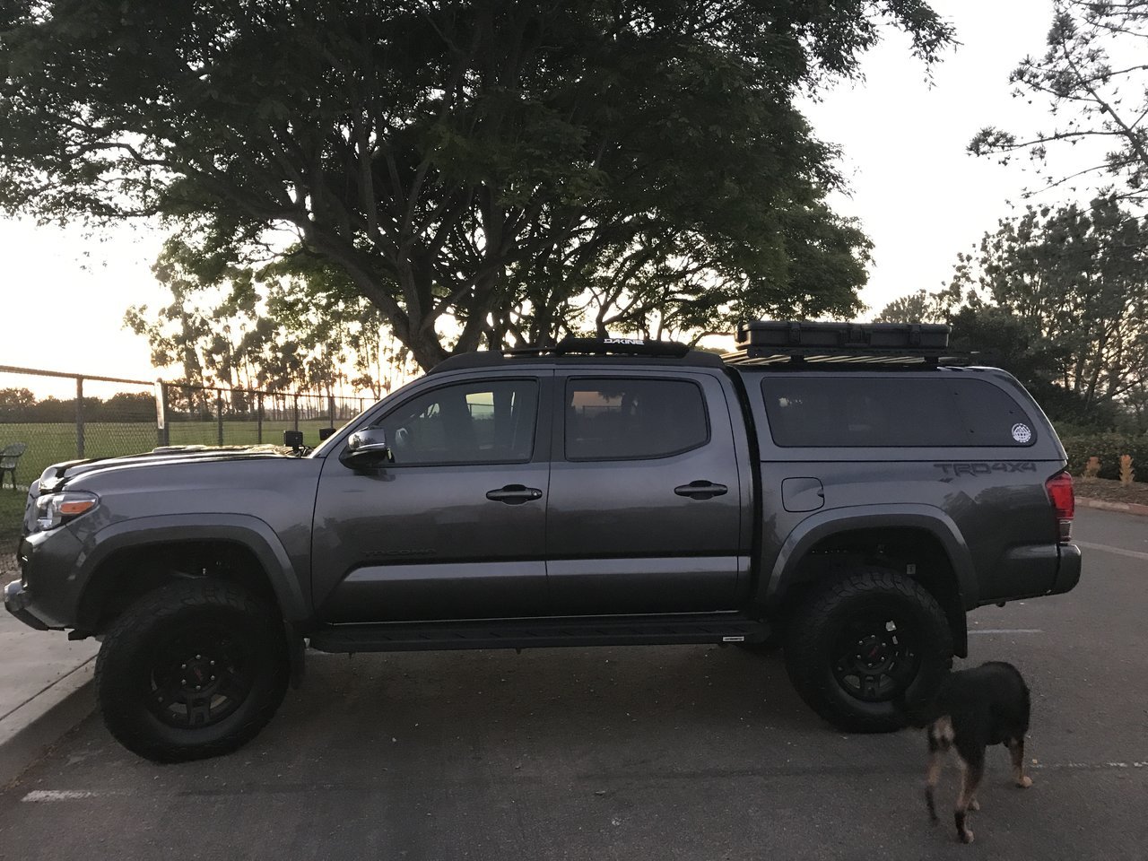

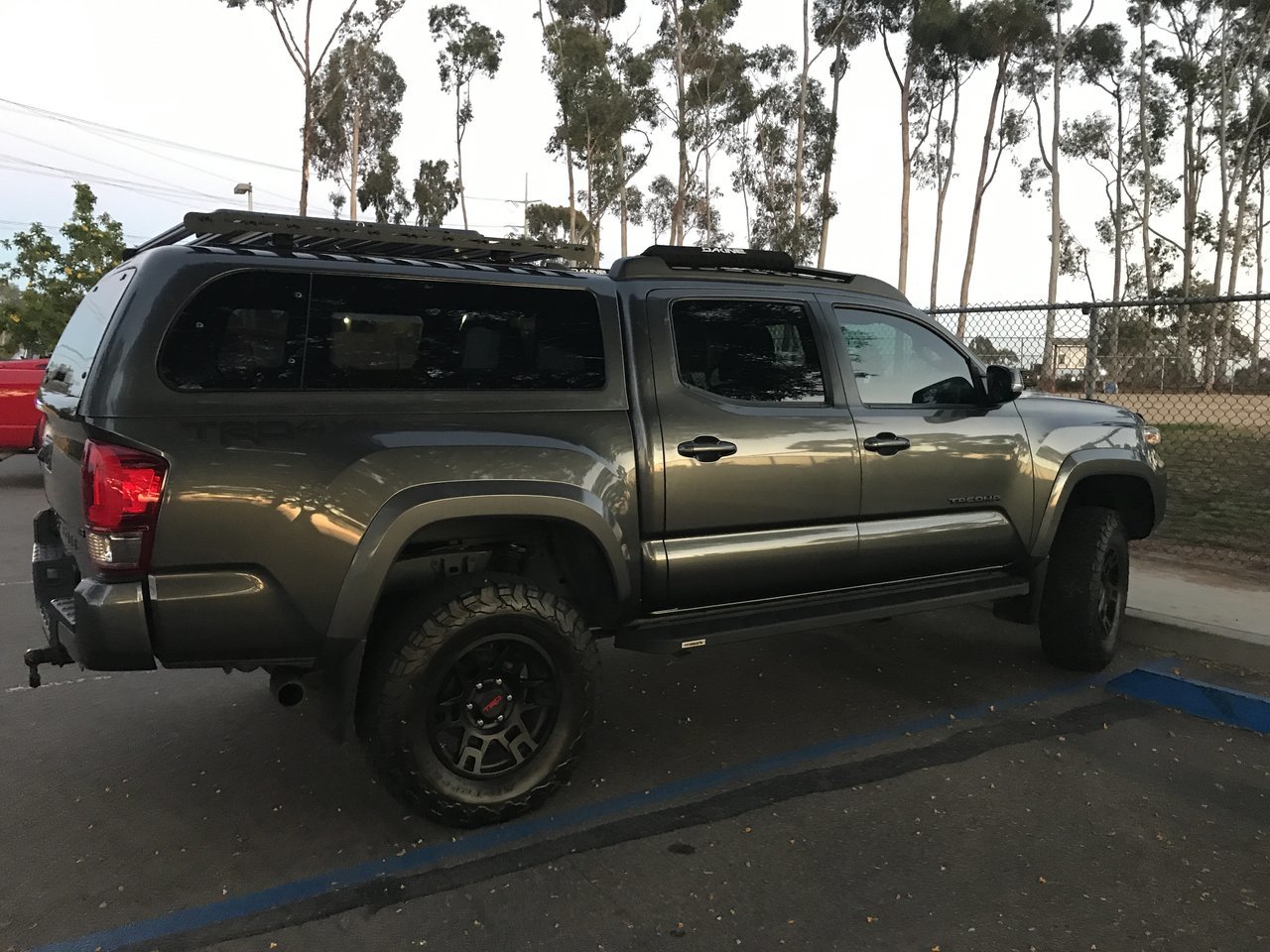

    sdsurfer
    sdsurfer @ODNAREM life...
    Jul 29, 2011
    #60790
    8,796
    Dirk
    San Diego
    DCSB TRD 4X4
    5100s/OME 888s. Dakar leaf pack. Total Chaos UCAs. DeMello Sliders. BAMF Recessed Grille. Prinsu Cabrack and Toprack.
    A few shots with the Dakars. Also have 5100s front and back with OME 888s.
    jaswifty, MGMTaco17, Dread1 and 7 others like this.

    That looks badass! Thanks.

    Thats nice ! On 16 inch?

    17"x 7" Sema TRD Pro wheels. I think I had 265 70s when the pictures were taken. Since then I moved up to 275 70s.

    What setting do you have your 5100's on ?Can we know the specific lift kit/package you got?

    5100s are set to 0.00. OME 888 front coils. Total Chaos UCAs.

    What are those running boards? My truck came with the predator steps which I am removing and I like the look and profile of those. I downloaded the photo but can't zoom enough to make out the brand.
    Thanks! JD

    Those are Go Rhino running boards. Got them from Auto Anything. I just recently put sliders on so I have these sitting in the garage. I'm planning to clean them up and sell them for pretty cheap. If you're in the SoCal area I'd be happy to set you up for a good price. They're pretty heavy so not willing to ship.
