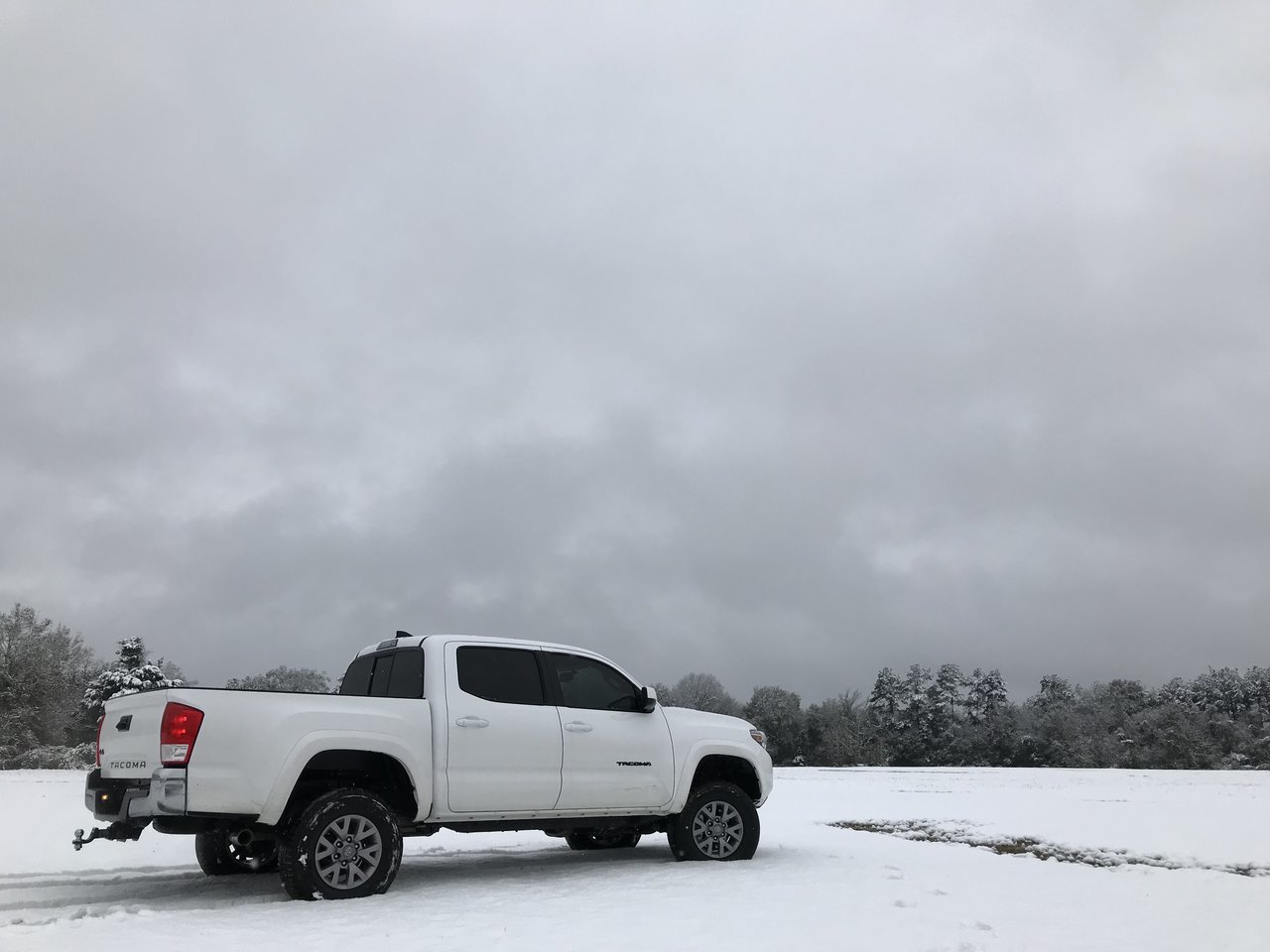

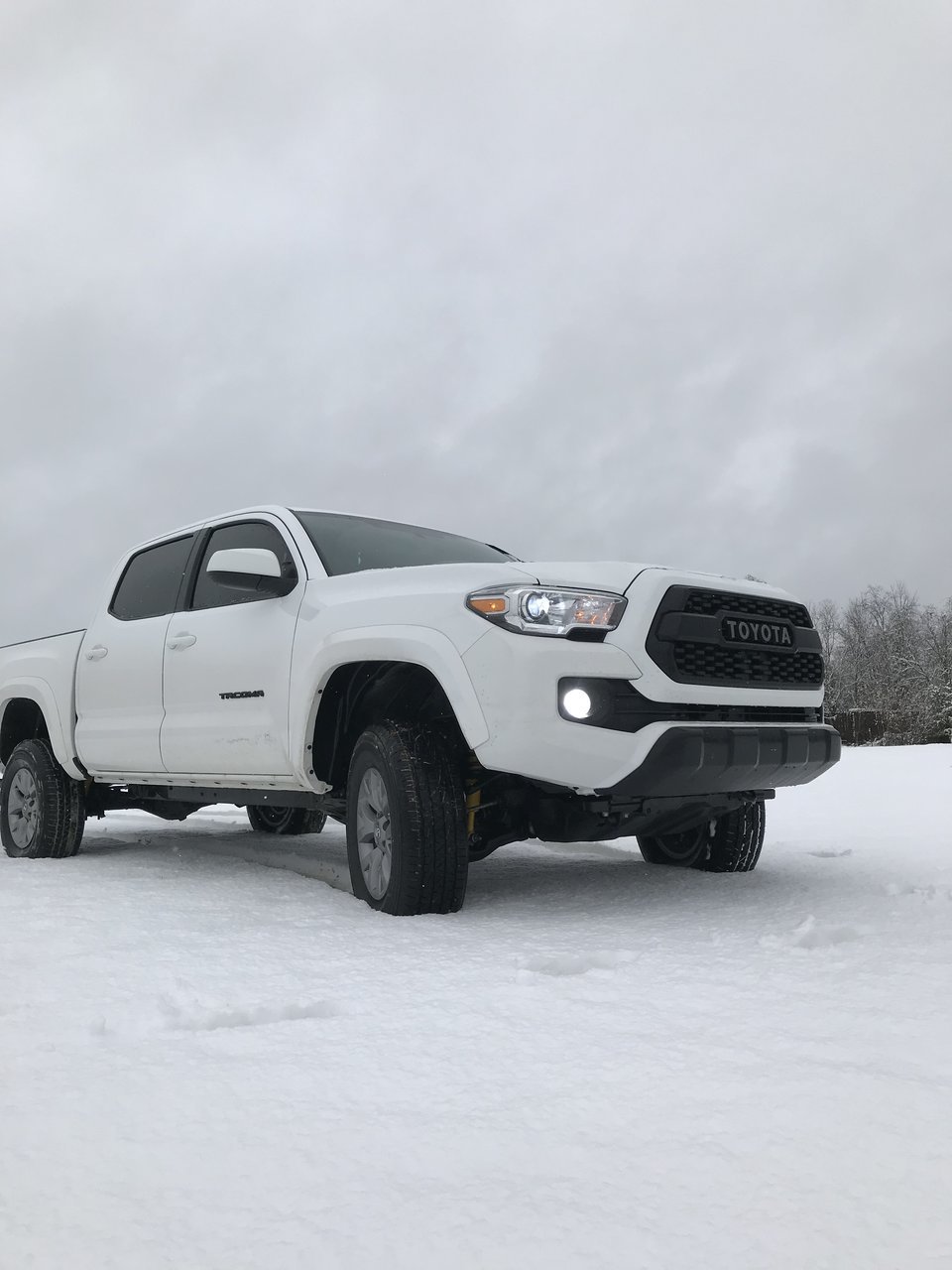

    New 3rd Gen owner and just put the ARB/OME suspension lift. Overall ride has improved in almost every aspect. I’m very pleased with this setup and feel very confident with it. New rims and tires in the next week or two!
    Just for anyone of you who were interested in the ARB/OME setup. Here it is
