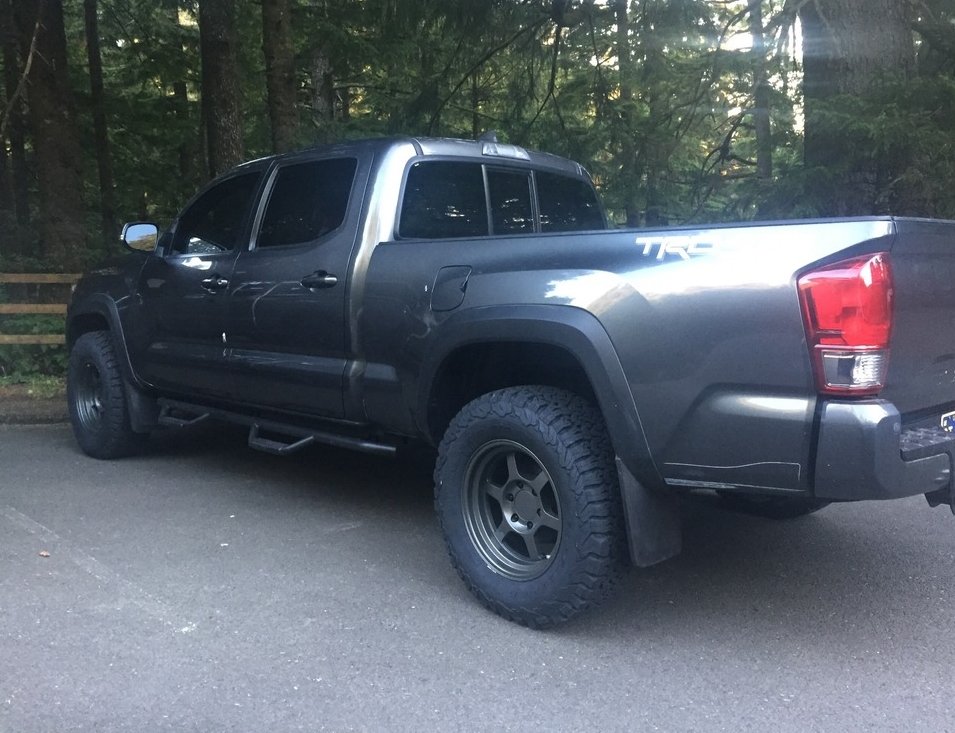

    First 2016 taco i have seen with scratches. I have to wonder about all of these hardcore offroad vehicles in mint condition.

    Nice lift Though
