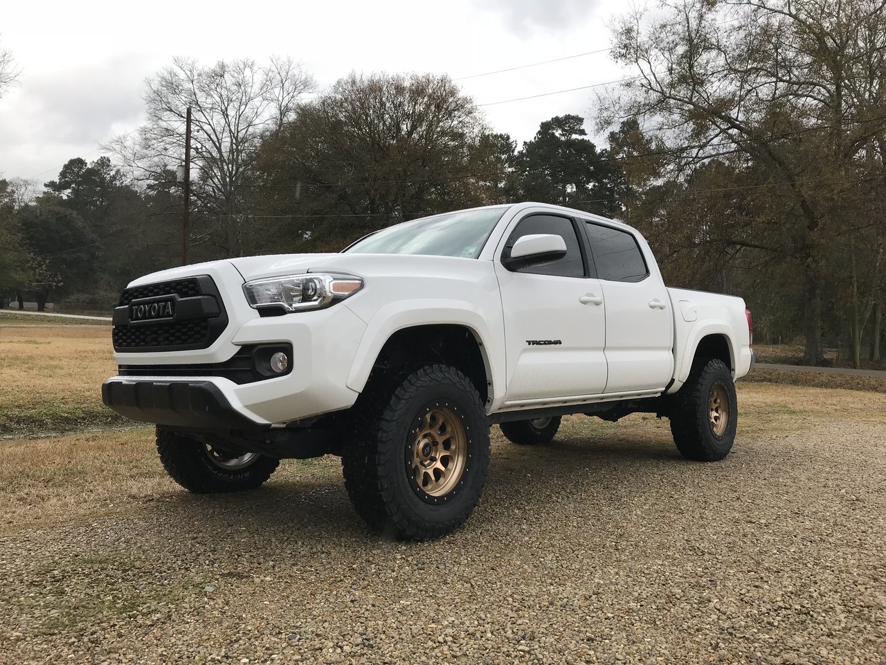

    Sorry man, just saw this. This is my buddies truck and he's running this kit.
    http://toyteclifts.3dcartstores.com...with-Bilstein-5100-Front-Coilovers_p_364.html
    Still with stock UCA's though he's wishing he spent the money on some new ones and the wheels when this pic was taken were 17.8 fuel trophy wheels. He's running my old Method roosts now.

    Why's he wishing he spent the cash on UCAs? Issues?

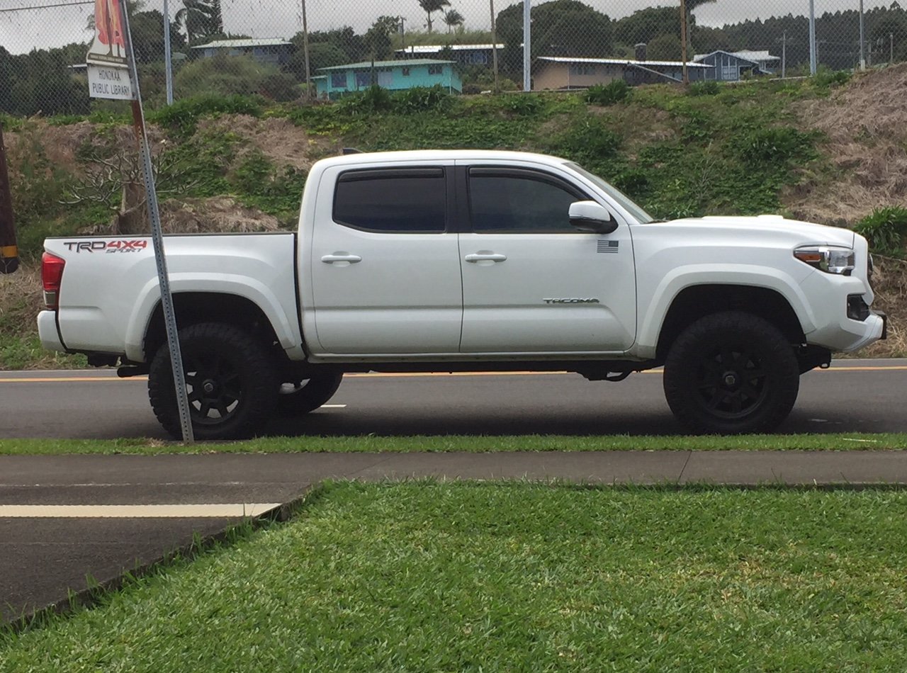

    Running the Toytec Boss 2.0 suspension w/ add a leaf. So far so good no complaints!
    SilverII likes this.

    On any big bumps and even some speed bumps he's maxing out the upper ball joint which is limiting his suspension travel and almost feels like he's hitting bump stops.
