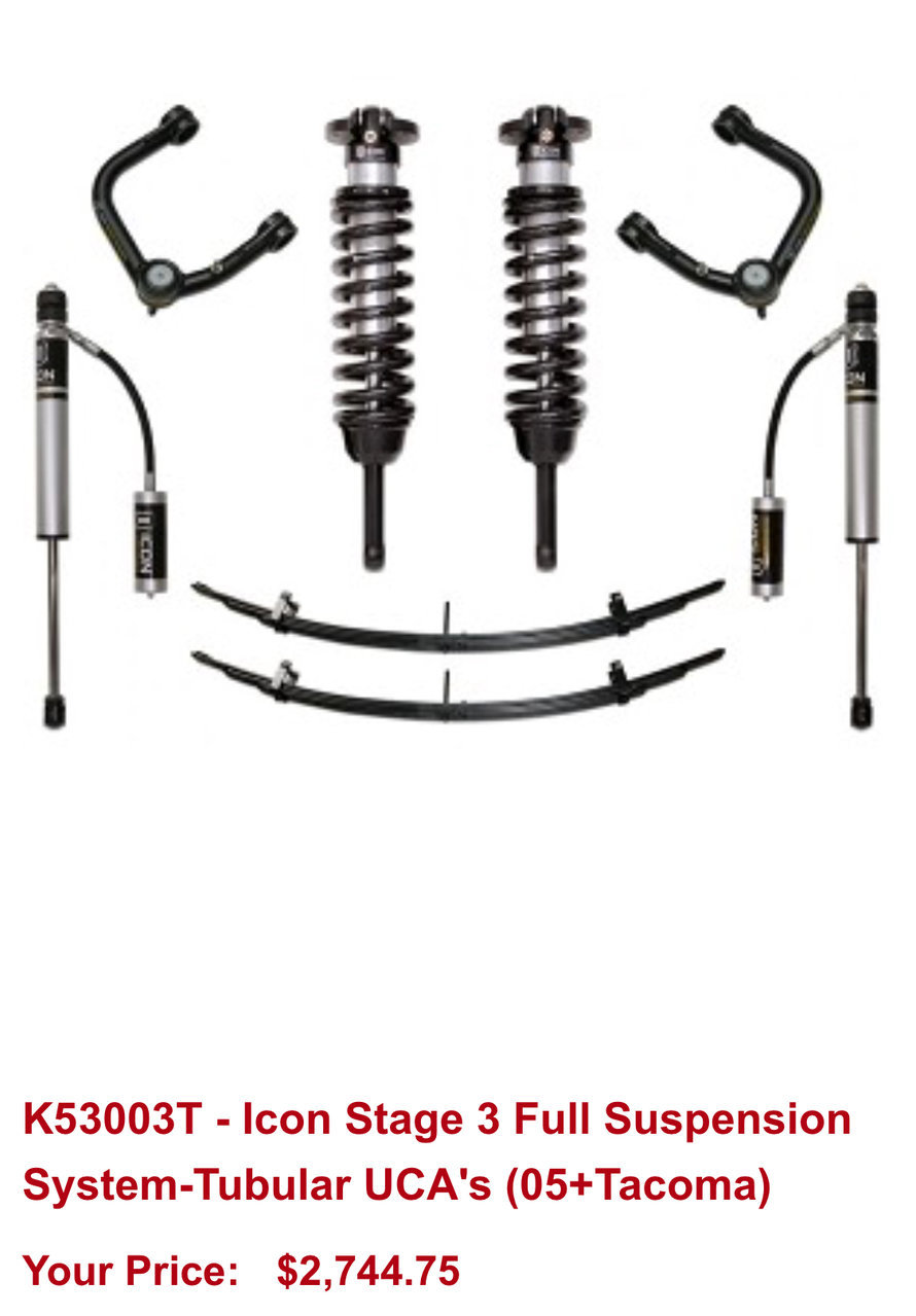

    I've read and read and read but I give up....I'm just going to ask.
    I have a 17 Long Bed Sport 4x4 and want to do a full suspension kit.
    The one I am leaning towards is the ICON Stage 3 with Tubular UCA.
    My questions are:
    1. Do I need (or should I) to add a Front Differential Drop Kit? Or does the ICON kit come with one like the ToyTec kits do?
    2. Do I need (or should I) to add a Front Swaybar Relocation Kit?
    3. Do I need to add some kind of upgraded rear bump stops with the AAL from ICON? Or is that included?
    4. Do I need to buy the extended front/rear brake lines for such a small lift (less than 3")?
    5. Can I run the stock (17") wheels with this kit installed while I pull extra shifts working the corner down at hotel drive saving up the small fortune it will take to buy the wheels / tires I want?

    Exterior: King suspension w/compression adjusters Icon billet UCAs Icon 3 leaf expansion pack Timbren rear bump stops w/U bolt flip kit Wheeler’s Offroad front superbumps BFG KO2 285/70/R17 on SCS Ray 10 17” wheels w/black wheel lock lug nuts TRD Pro grill TRD Pro taillights TRD Pro skid plate Demello Offroad front bumper Smittybilt XRC 9.5 comp winch w/Factor 55 fairlead and Flatlink E RCI LCA skids Beast Fab rock sliders 4 Extreme LED 4” pods Baja Design Squadron SAE LED amber fog lights Relentless Fab bedrail mount w/KC Flex dual amber chase lights AVS vent visors Interior: TRD Pro shift knob OEM instrument switch panel conversion (from 3 to 5 slots) Taco Garage DMM with Scosche Magicmount Upgraded Kicker sound system Husky X-act floor liners Performance: Airaid cold air intake system Pedal Commander w/Bluetooth

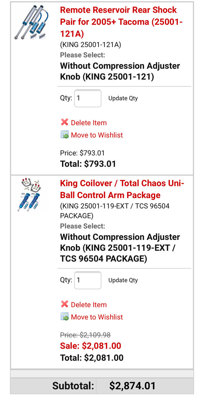

    1. No need for diff drop with a 2.5” lift. Try not to max your lift at the 2.75” unless you really need clearance for tires. It’ll ride stiffer with too much preload.
    2. I believe you do have to get one if you want to keep your sway bar but not sure how Icons packages are setup. Kings shocks has the relocation built in the reservoir bracket on mine.
    3. Bumpstop not included. You only need to upgrade if you feel you will bottom out a lot more from off-roading. Not necessarily needed but is a nice upgrade to cushion the bottoming out especially if you plan on carrying extra weight.
    4. You do not need extended brake lines with this lift. The rear is only going up 1.5” with this kit.
    5. Yes you can run with what you have but it might look like you skipped leg day. Maybe just put everything on but not the add a leaf for now and only adjust the front coilovers to level out and when your ready for wheels/tires, crank it up and install the leaf.
    Good luck!!
    PS I might be a little bias since I have Kings but for the almost same price of the stage 3 Icon tubular, you can get Kings 2.5s with reservoirs all around no adjusters with some Total Chaos UCAs. Icon Stage 3 comes with no front external reservoirs and the rears are only 2.0’s. Then maybe buy add a leaf separately which is only about $200. Just saying unless you’re getting a ridiculous deal on the Icons this option is way better for the money.

    Thanks for the feedback. I change my mind by the hour as far as which kit to get. One minute I convince myself that I will be fine buying the kit at Kmart for $58 and the next minute I’m convinced that I “need” the King kit for $58,000

    I say go big if you plan on keeping your truck for a long time. Any of the vendors on here will probably give you a great deal. Since we are on the toytec thread, maybe you should hit them up and see since they do carry Kings.
