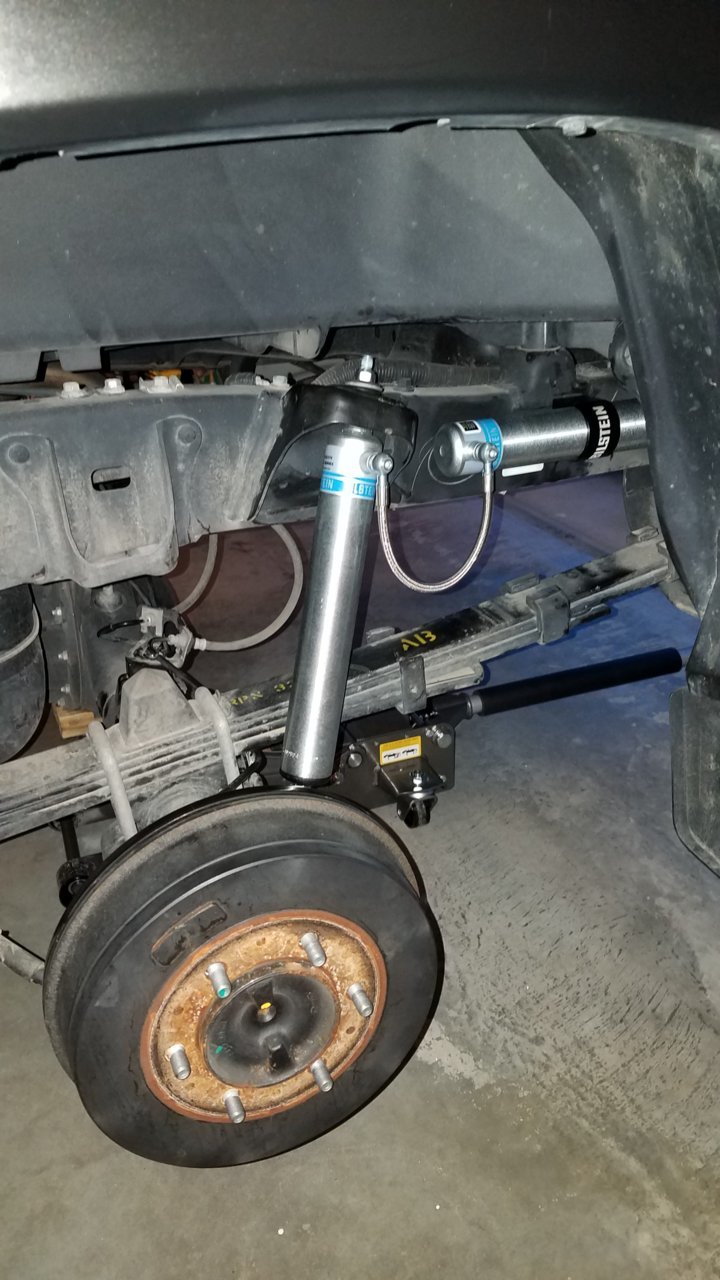

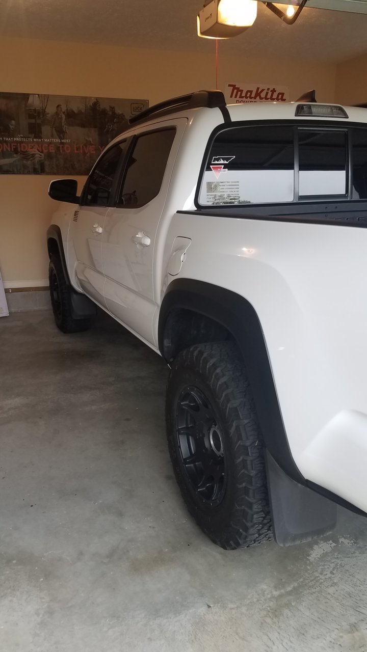

    How I spent my Friday off..
    Installed some bilstein 5100 set to 1.1 on the front. I used the floor jack method to decompress and compress oem coils; worked like a charm and never felt unsafe.
    Have some bilstein 5160s for rear but waiting for front to settle to see if I need to add a lift too.
    First time doing suspension work & I am beat....
    Sushi for dinner to celebrate; hopefully nothing flys off....

    Thanks for the pics - hopefully that setup works for you.
    PS - love those Methods!

    No good ones, but I went ahead and added the bilstein 5160s yesterday.

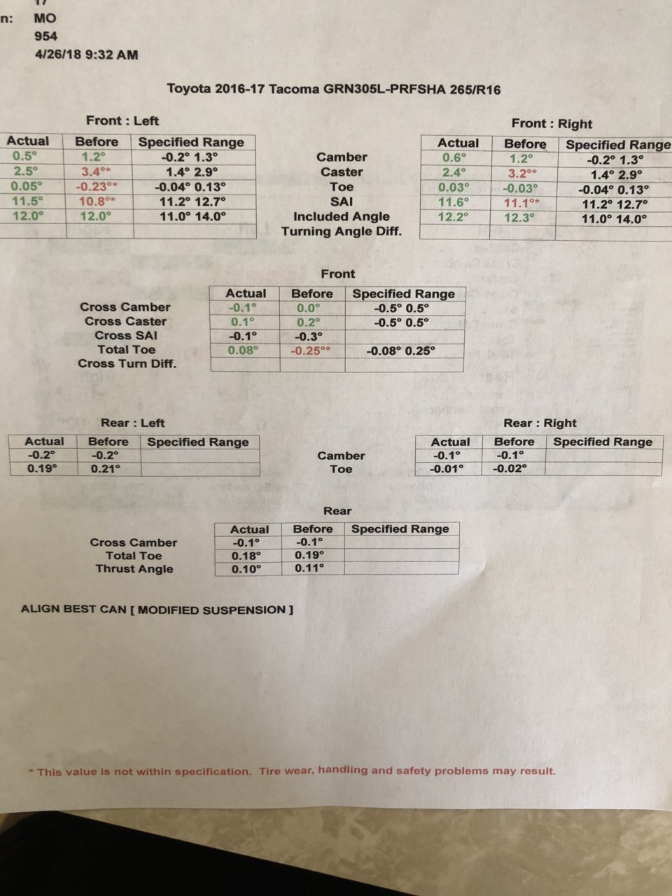

    installed a stage 3 lift by icon with tubular uca and delta joint. then in the rear added the progressive aal pack. i also removed the overload spring. job took me around 13 hours. happy with the results!
    cranked the coilover about 6 or 8 turns if i remember correctly
    alignment specs are near perfect
    alignment guy told me was easy to get it in spec and was impressed how close he could get it in range

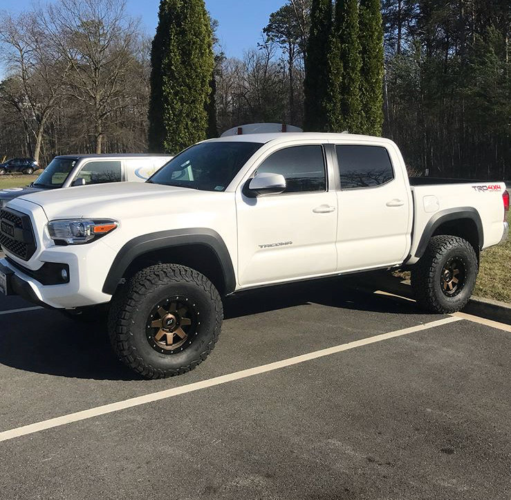

  17. May 3, 2018 at 2:01 PM
    #3437
    Theshortbusmafia
    Theshortbusmafia Well-Known Member
    Feb 15, 2018
    #244499
    81
    Justin

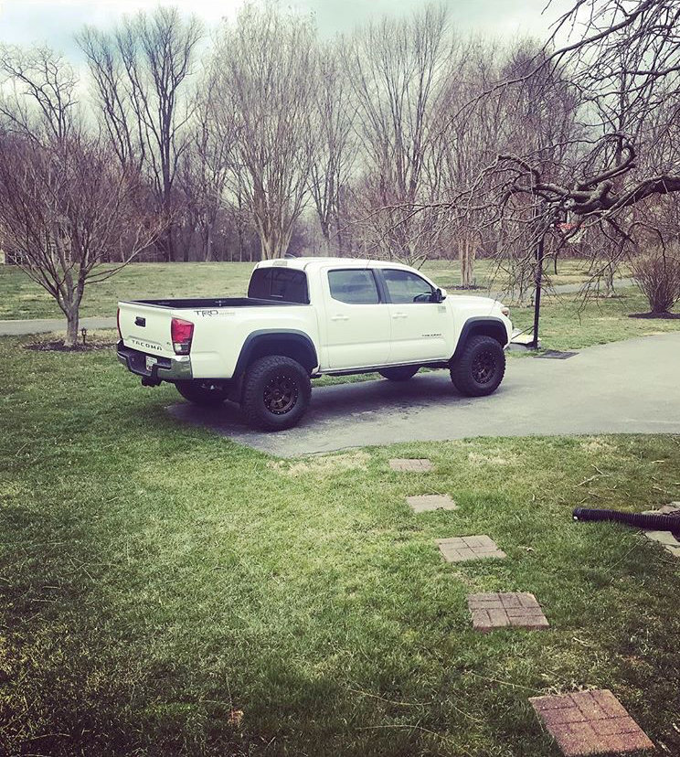

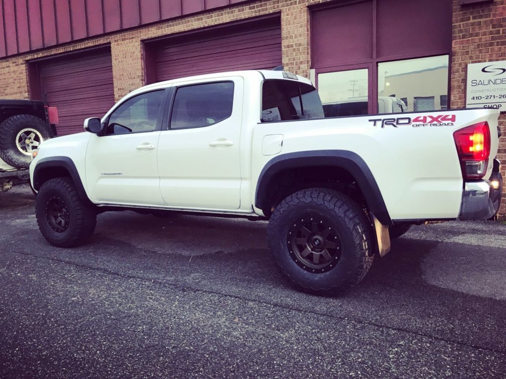

    2017 Tacoma Offroad
    Not sure why my pics didn’t upload the first time. Anyway here’s some shots I got shortly after the lift was installed. I’m extremely happy with the outcome, rides amazing, no vibe or taco lean after 1000+ miles. I however sag in the front more than expected-it’s sitting almost at factory rake. I may go up to the 2nd notch in the front .65 just to bring it back up and avoid rubbing.

    MikeR585
    MikeR585 Well-Known Member
    Jul 13, 2017
    #223979
    76
    Vancouver Island, BC
    2017 MGM Tacoma TRDOR
    That looks really good @Theshortbusmafia - you can definitely see the 295’s are really big. Hope that second notch works out - it looks great as it is
