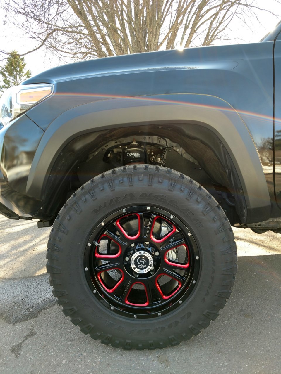

    3" lift 275/70/18 GoodYear Duratrac Granite Alloy Wheels 18*9.5 with 4.5" backspacing. Hard trifold tonneau (Toyota) 30" Auxbeam Light Bar with NFab behind the grill mount KN Blackhawk intake

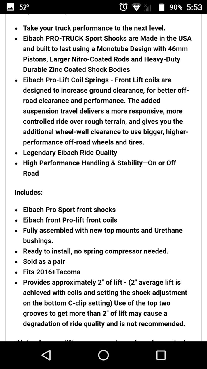

    Screenshot_20180522-055319.jpg IMG_20180422_153052425_HDR.jpg I currently have a RevTek spacer lift in my 2017 TRD off-road. Center of hub to wheel well is 23.25"... so approximately 2.25" of front lift. Full droop being 24.5", doesn't leave much droop travel IMO. How can I get more droop travel (another inch) without loosing lift? Would the Bilstein 5100s with lift springs, or Eibach coilovers do the trick??

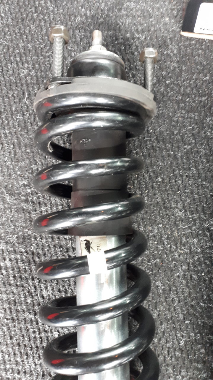

    I had these put together for me. 5100, 887 and kyb top mounts, extended studs.20180531_113637.jpg
    Will they straighten out once installed since its just a bushing and bolt holding it together right now?
    *edit. After alot of reading i think they forgot a washer under the top mount. Heading back to the shop now

    Did they straighten? I have a set I never installed that looks the same way

    2017 Tacoma Offroad
    I’m no gynecologist, but I don’t think those are assembled correctly...

    Looks to me like someone installed the springs incorrectly and they're not sitting on the perch. It's not uncommon for springs to only go in one way and if you flip them, you get a little bulge like that.

    I havent installed mine yet. Both sets look like warped springs. They double checked and mine are put together right. I think they will just pivet and straighten out once installed and some weight on em. Hopefully
