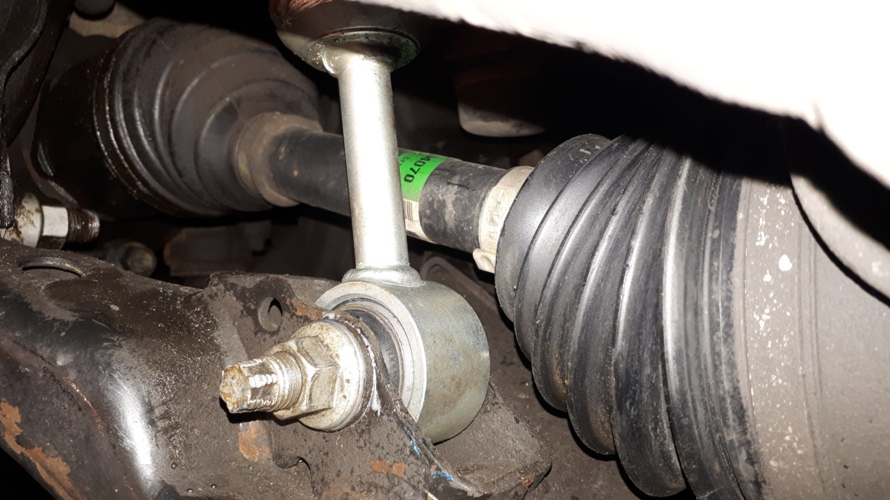

  5. Jun 13, 2018 at 6:24 PM
    #3465
    gmarrero89
    gmarrero89 New Member
    Feb 9, 2017
    #210136
    4
    Is it just me? I really think those lower spring perches were installed upside down.
    TRDTacoTrey likes this.

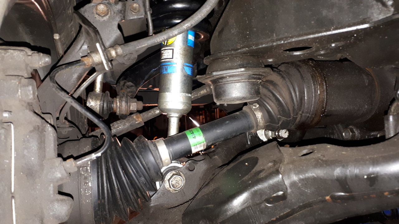

    Hey everyone, I just managed to get my front end done this evening by myself after a couple hickups
    3rd gen 5100
    887
    1/2" top spacer on driver side
    1/4" on passanger
    Spc uca's
    I know itll take time to settle, but as of right now how do my angles look? Pretty bad eh. How do i correct this? After it settles and an alignment? Dakars go on tomorrow
    2nd question. It sits real high right now, the only thing i waited to torque once the wheels were on the ground and bounced some was the lower alignment cams on the lca. Is that correct?
