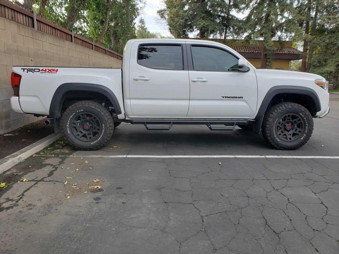

    3rd gen specific Bilstein 6112s set at 4 and 3 in the front and 5160s in the rear. No AAL, leaf packs, or blocks in the rear. Goal was to level out the front to the rear stock height. First day the front was about 3/4 inch higher than the rear after alignment (bro lean). Today I measured, 3 days later and about 100 miles of driving, the front is less than 1/4 inch higher. Hopefully with a few more miles the fronts will settle to about even or a slight rake. If the front drops a little more, I'd say I achieved my desired lift. Will be adding either SumoSprings or air bags to aid when towing.
