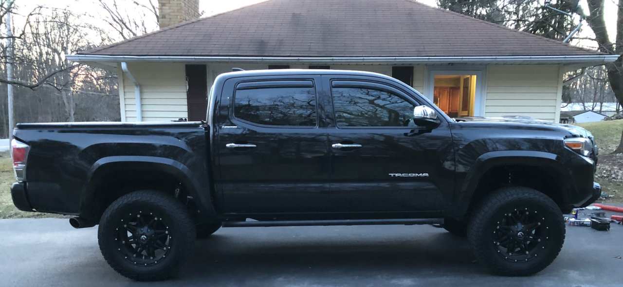

    I installed 2nd gen 6112s on the top(5th)notch and 5160/HS 3 leaf AAL with overload in. I got 2.5” in front (which is exactly what the chart says to expect)and 2” in the back which puts me at 23” hub to fender all the way around. For reference the only extra weight I have is a extang solid fold tonneau and sliders.

    I have the HS 3leaf as well. I have OL out and sit 1.5 higher in the rear. I’m currently at 23.5 rear. Did u get full 2” with OL in? How is the ride with the OL in place? Thanks for your measurements. Do you have a side profile pic and tires your running?

    The overall ride is way better than the stock limited suspension. I did get a full 2” with overload in.

    Man that looks Rock solid. What size tires you running?

    Thanks! I appreciate it! They are Falken Wildpeak 275/65/18

    Noice. Just noticed that is a Limited with the fancy lights too....

    Looks great. So your front end is sitting at 23” hub/fender? Thanks for the photo!

    Thanks! Yup right at 23”
