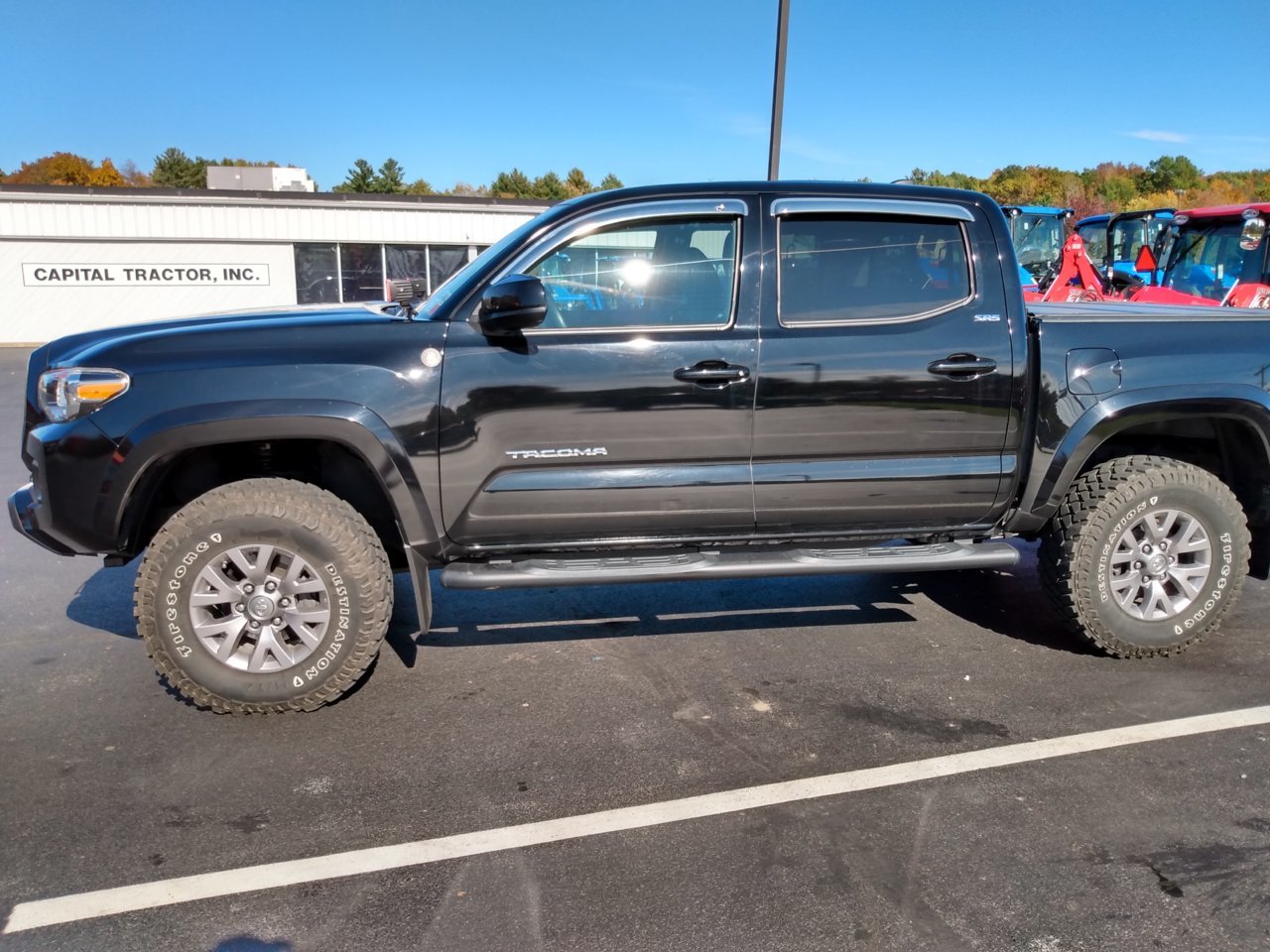

  20. Oct 13, 2019 at 6:00 PM
    #3580
    SSG (03)TACOMA
    SSG (03)TACOMA SSG TACOMA
    Dec 17, 2016
    #205045
    448
    2023 DOUBLE CAB V6 TRD SPORT 4x4
    IMG_20191013_140312022_HDR.jpg2" front left with with1" block,
    Rear 1" lift with block, so 2" all the way around,
