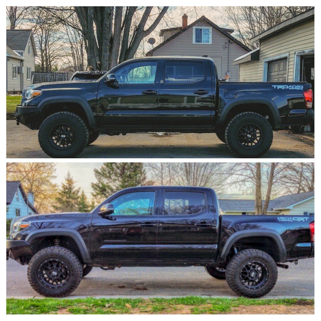

    Looks good. Like the stance

    What setup is this? Looks perfect:thumbsup:

    Seconded. What was the leveled setup too?

    It's a Frankenlift... 2" Eibach pro lift struts with 1/2" Toytec top-spacers and 1" diff drop. 3" total lift. Factory UCAs aligned perfectly yet, although I do still have future plans to go with aftermarket to gain some more travel. 3" Tuff Country lift blocks and Bilstein 5125 rear shocks.

    Leveling Kit was a RevTek 427 spacer kit. 3" front and 1.5" rear blocks.
