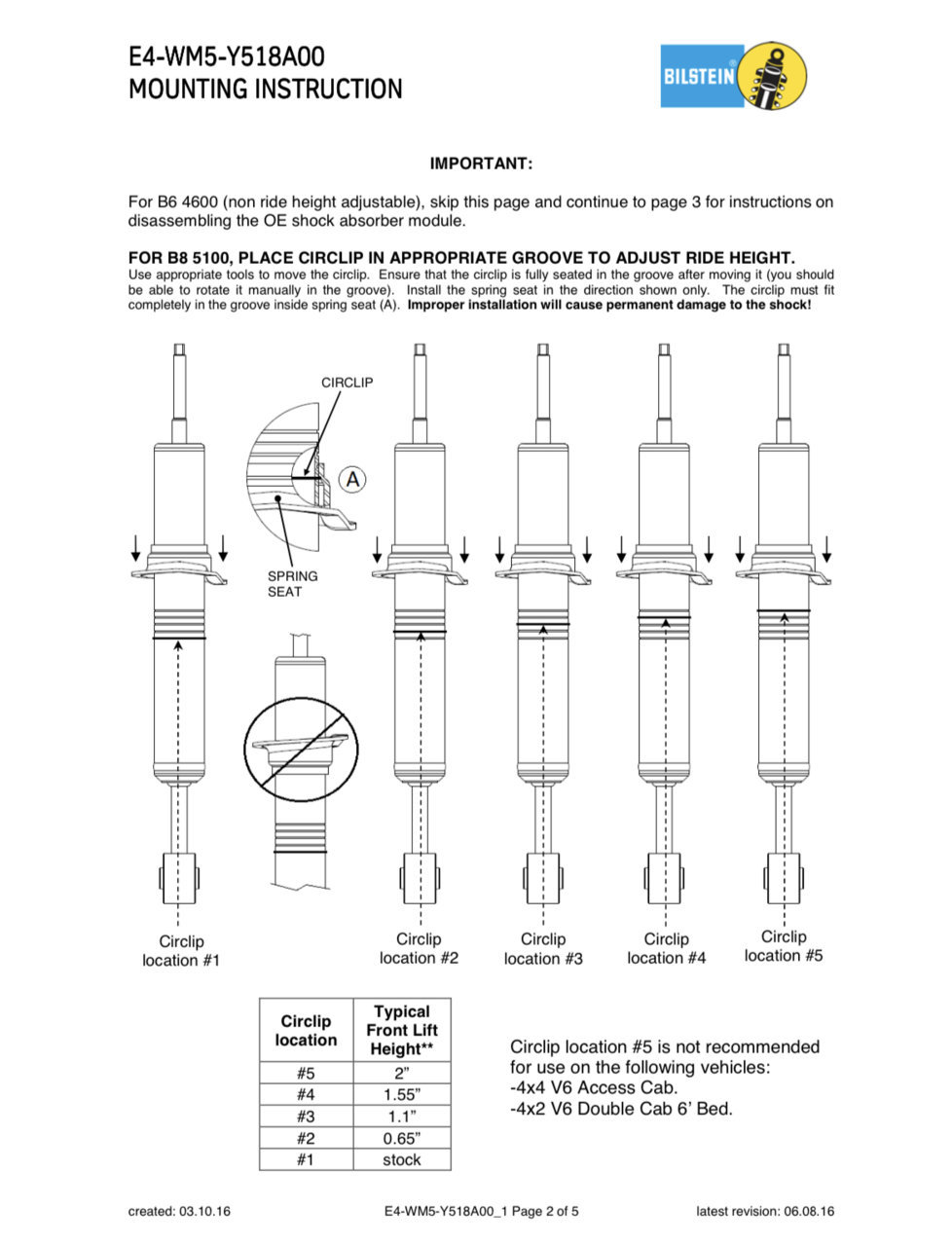

    Hoping to revive this thread for others wondering the same. Recently ordered some Bilstein 5100s for my 2016 AC 2.7. Question is - if I’m trying to reach between 2 - 2.5 inches of lift in front, would that mean I set it on 5th notch? Trying to avoid UCA upgrades by any means. Also would like to not have completely stiff ride, and not feeling too comfortable about using OME springs. Any input would help!

    According to your chart, the 5th notch is where you need to be.

    I hear ya there. From what I've gathered, that 5th notch will net you a hair less than your target, BUT since you have the 2.7 (good find, I miss mine) you might end up right in your target range.

    Regarding the suspension it seems like I’m gonna have to trail blaze. I’ve seen on multiple groups were some people leave one side on the fifth notch, and in the passenger side on the fourth notch. Toytec has told me to put them both on third notch and if I get the Taco lean, to go back and add a small spacer. They also advised me that the 5100s aren’t designed for the OME, but I’m a bit skeptical on that. I’d be fine to go with OME but I’m not sure what coil would give me a clean 2 - 2 1/2” lift since it seems like the 4 cylinder Tacomas are raised 1” higher than our V6 counter parts.
    Seems like there’s no right way to do it, so I’m hoping whatever I go with initially works.
