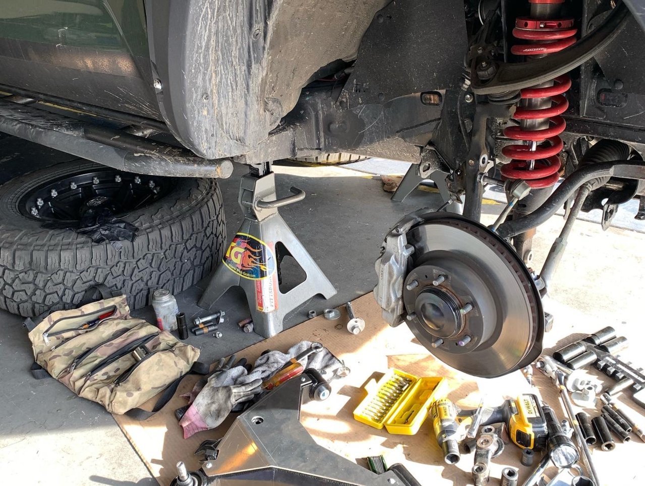

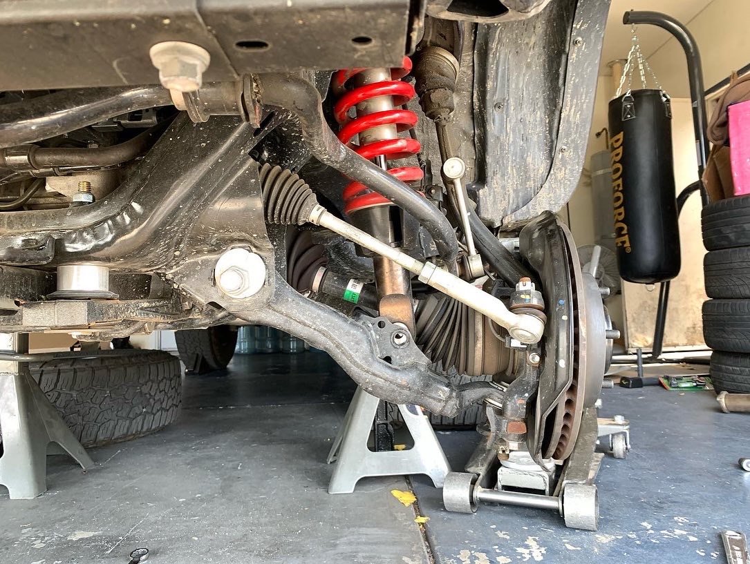

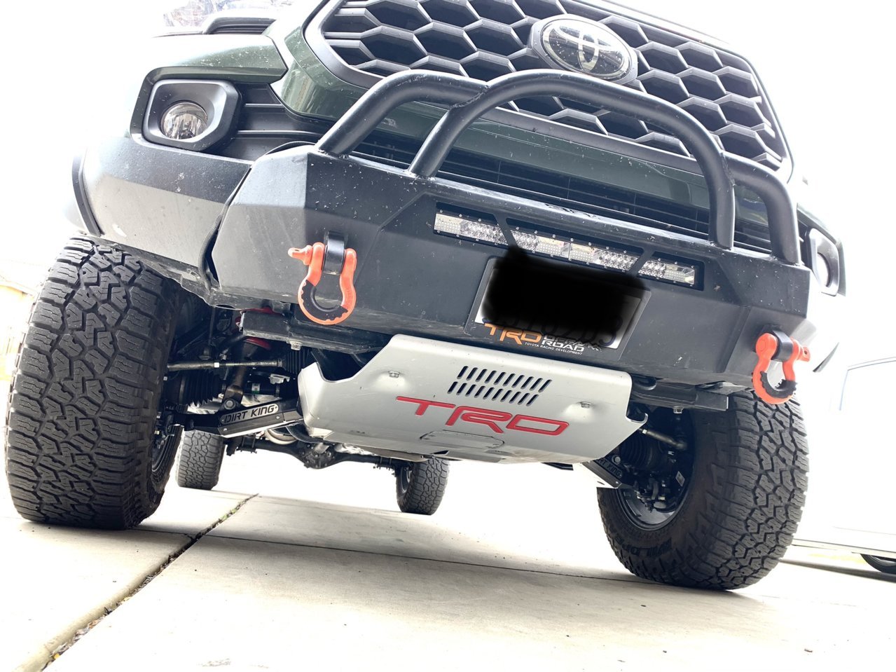

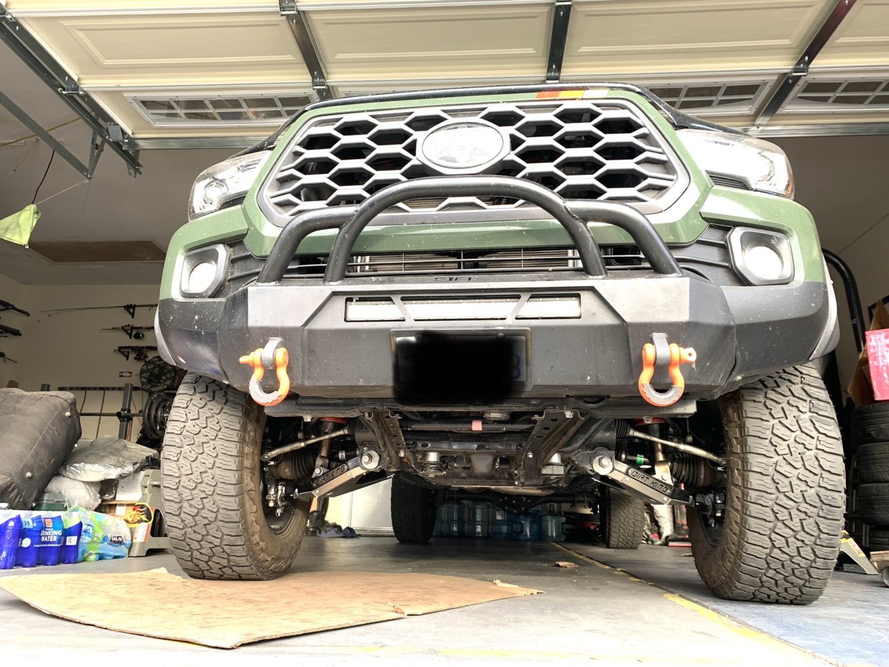

  14. Mar 28, 2022 at 6:40 PM
    #3694
    neegdogdig
    neegdogdig Untrained with bad experiences go go go!
    Mar 18, 2012
    #75151
    1,915
    3rd Gen DC V6
    02F7E664-7029-4871-9AC5-E2AC752150C9.jpg 8FD0B0A7-0BCA-4BA0-B714-C22E218EED02.jpg 89A6CD69-2994-42FD-ABBB-DC39E8EB51D4.jpg C51F9AF4-8930-4263-A2AA-ECBC43EBB207.jpg 3F615F4F-58AB-4080-9A57-DFFC0D718C3F.jpg 9A513732-BFAC-446A-810B-CD1E8B24140F.jpg 632A3BC2-A5DF-43E6-9759-3EAA80FA1CEE.jpg 9B55F734-2D74-47AA-99CB-6E5C9515F7E8.jpgShe's getting there
    JDSmith, 4xThad and CygnusX191 like this.
