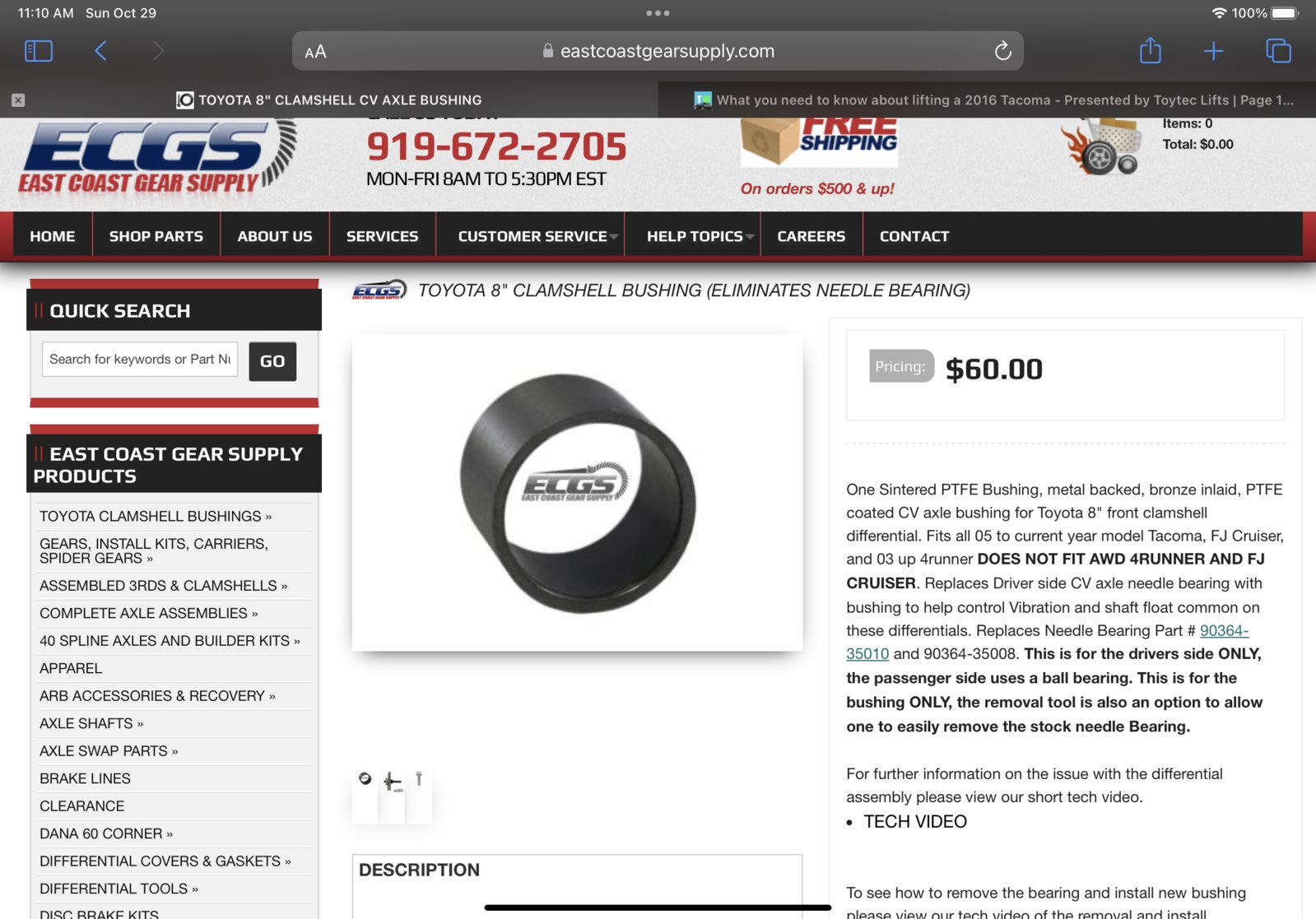

    Mine is around 3” and I hear a very slight hum…..hum….hum vibration between 28 to 38 mph. A very low vibrating hum that does a not change with speed. When i engage 4 wheel it stops immediately. I feel that it is coming from the from the front drive shaft rotating while in 2 WD ? Thoughts ?

    If it goes away with four-wheel high engaged, it's your front needle bearing. You'll have to pull the CV axle and replace the bearing with a solid one, probably from east coast gear supply

    Thanks form the info. Seems simple enough. Will it wear and cause damage over time? Do you advise I remedy immediately ?

    I mean, what eventually happens is the needle bearing breaks apart and you get a bunch of metal splinters and pieces inside your front differential. Won't hurt anything until you try to use four-wheel drive... Then it can blow up or lock up your diff.

    I will take to my suspension guy and have it swapped out. Thanks for for info. appreciate you.

    This guy ?

    That's the one
