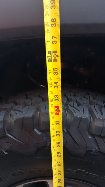

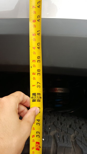

    GUYS!!!!? my driver side is sagging all i have is 1.5 inch aluminum spacers.... my local suspension shop says my shocks could be "breaking in" is this true!?20151221_132329.jpg 20151221_132257_001.jpg

    Time to get rid of that spacer lift maybe? Are those 285's rubbing yet?

    1inch sagging seems quite a bit. Are they the same size spacers on both sides?

    Ok, so I am new to this "taco lean"..... what does it mean and is it common? They are the same size spacers....... And no the tires do not rub on fenders but they do catch a little bit of the UCA at full lock.....

    Did you replace coil springs? Also park at level ground and measure from center of your hub to fender. "Taco lean" means your battery and gas tank is on same side of the vehicle resulting "lean"

    You have spring spacers or strut spacers?
    Any chance you broke a spring?
