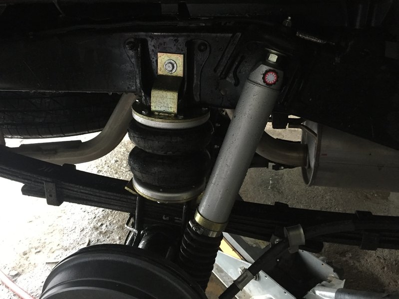

  18. Jan 6, 2016 at 10:32 AM
    #758
    Livinserene
    Livinserene Thejerkyguy
    Nov 15, 2013
    #116646
    875
    Kevin
    Nova Scotia
    18 sport mt Ovtuned
    OV TUNED MOFOS
    I went to a local spring shop and they did an add A leaf for me ,, gave me some more capacity and 1.5 " lift,,I also added bags for when I load it up and haul my trailer ,, still waiting for cap for which I'm sure will settle springs a
    image.jpg bit
