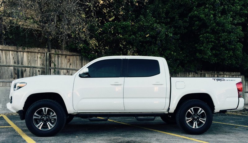

    do you have a side on front picture with the new Nitto Tires? I am looking to add those same tires with my Stock sport rims.

    Bilstein 5100s all around, Toyo All Terrain AT II 285/70/17, Custom Car Grill, front windows tinted at 35%, door still protectors, bed Matt, tail gate lettering, center console organizer and detailed with Adam's Polishes products
    I'll take a picture and post it up tomorrow. By the time I get out of work it will be dark.
