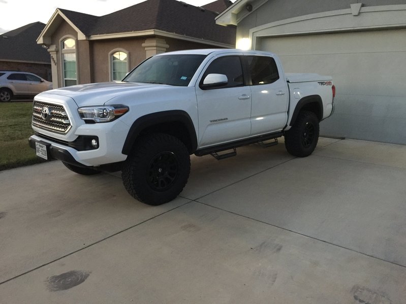

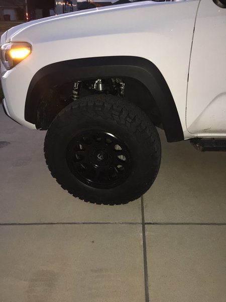

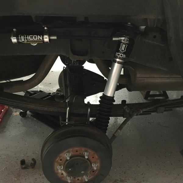

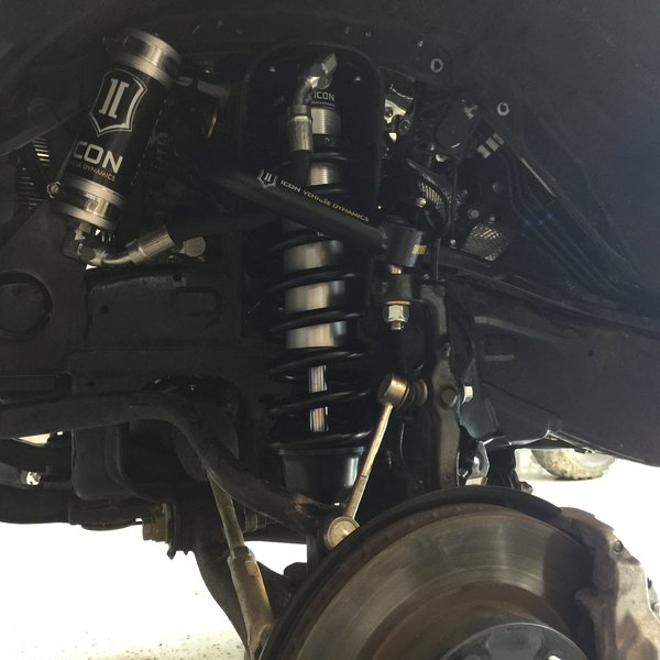

    Ok so I finished installing my icon stage 4 took a total of 3 hours to finish and the ride with factory tires is great. I had to cut off both upper control arm bolts. Didn't want to try to bend up my sheet metal. Once I installed my bfg ko2 it got a little rough but I'm going to try different tire pressure. image.jpgimage.jpg image.jpgimage.jpg image.jpg

    285/70r17 ko2 the wheels are 17x8.5 offset +7.4mm so about 5" back spacing. I have a little rub on the fender flair with the tires turned slightly but I'm hopping after the alignment that will take care of that.

    I did from floor to fender it was 35" in the front after the lift it was 36 3/4.
    The rear was 35 1/2 defore after was 38
    I did have to preload the drivers side coil over about 4 turns from factory settings

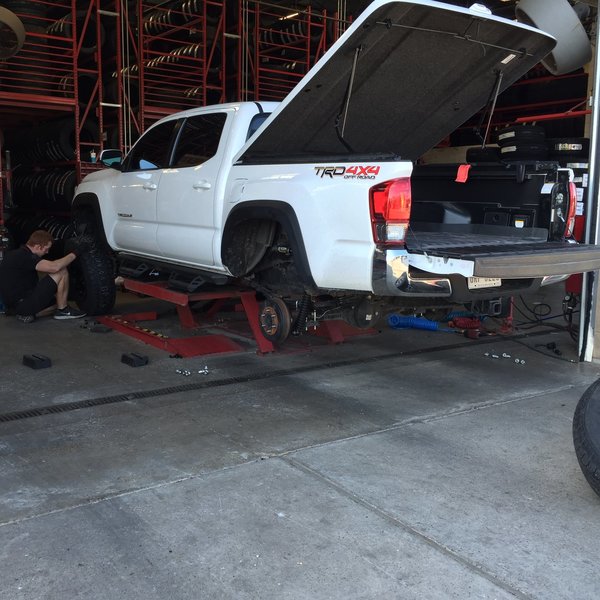

    Ok so I had the alinment done they set the caster to 3 degrees and it didn't help the slight rub. After looking a little closer I found a spot where it rubs on the cab mount. So I guess even though I didn't want to do it I'm going to have to do the CMC.
