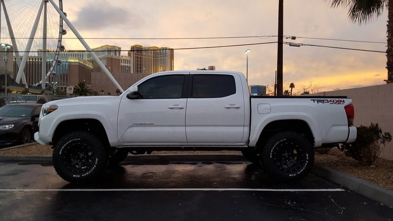

    Installed OME 885s, 1/2 top plate spacers and a taco lean spacer, Bilstein 5100s all around, TC UCA's, Wheelers HD Progressive AAL without overload, SCS SR8 wheels with BFG KO2s 285/70/R17. No rubbing and alignment is in spec. Feeling sore from the install, but super satisfied with the results and ride. Just a tad bit stiffer than stock, which is 10x better IMO.20160119_165353.jpg

    That looks bad ass. Mine should look similar.
    What alignment specs did you use and any tips on rear prog adds leaf install?

    I didn't even bother for the $10 dollars I cut the passenger side. Honestly I wish i just bought 2 bolts and cut both sides. Soooo much easier...

    From what I hear passenger side is near impossible. I didnt try it, I just bought a replacement and cut the old one out.

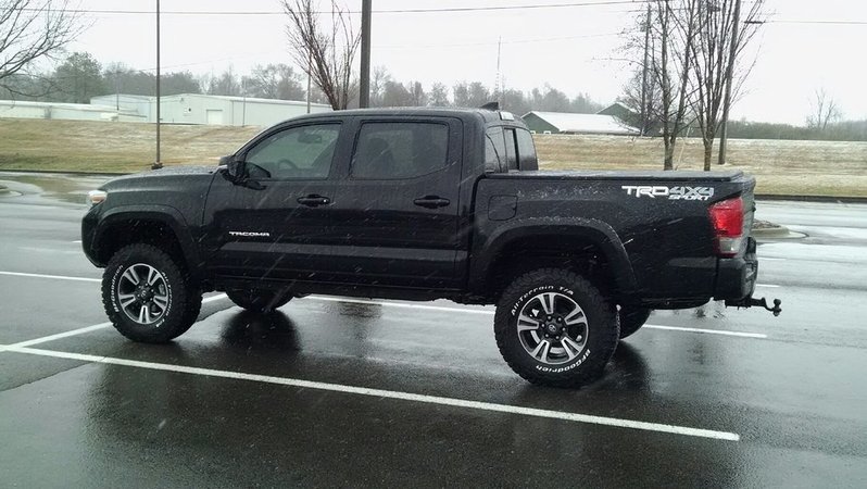

    Supreme Suspension 2 inch front and 2 inch rear.. Beefy Taco
    andyboyd102, Macdadi and texanhoyt like this.
  15. Jan 22, 2016 at 3:53 PM
    #935
    Double O Joe
    Double O Joe Member
    Jan 22, 2016
    #175713
    16
    Joey
    2016 Tacoma Sport 4x4
    Mine was either going up or down through 15-25 mph... Putting the lift on has it from 15-55 now. growling, moaning, and raising hell.. Pop it in 4wd it immediately goes away. go to 2wd and it comes right back
